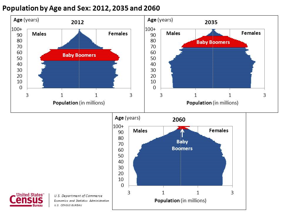

I wonder, you are not the only one I hear about this predicament from.
It seems to me that the impact of China and the home centers is inevitable. What percentage of the shop went under as a result of the 2008 crash?
That is not to say that home building will not be strong starting in 2020 because of this graph. Just not sure how much the custom shop is going to participate.
The BLS predicts a 24% increase in the demand for carpenters and an 8% growth in the demand for cabinetmakers.
BTW you might want to at least consider the monthly mail out, it really does work.

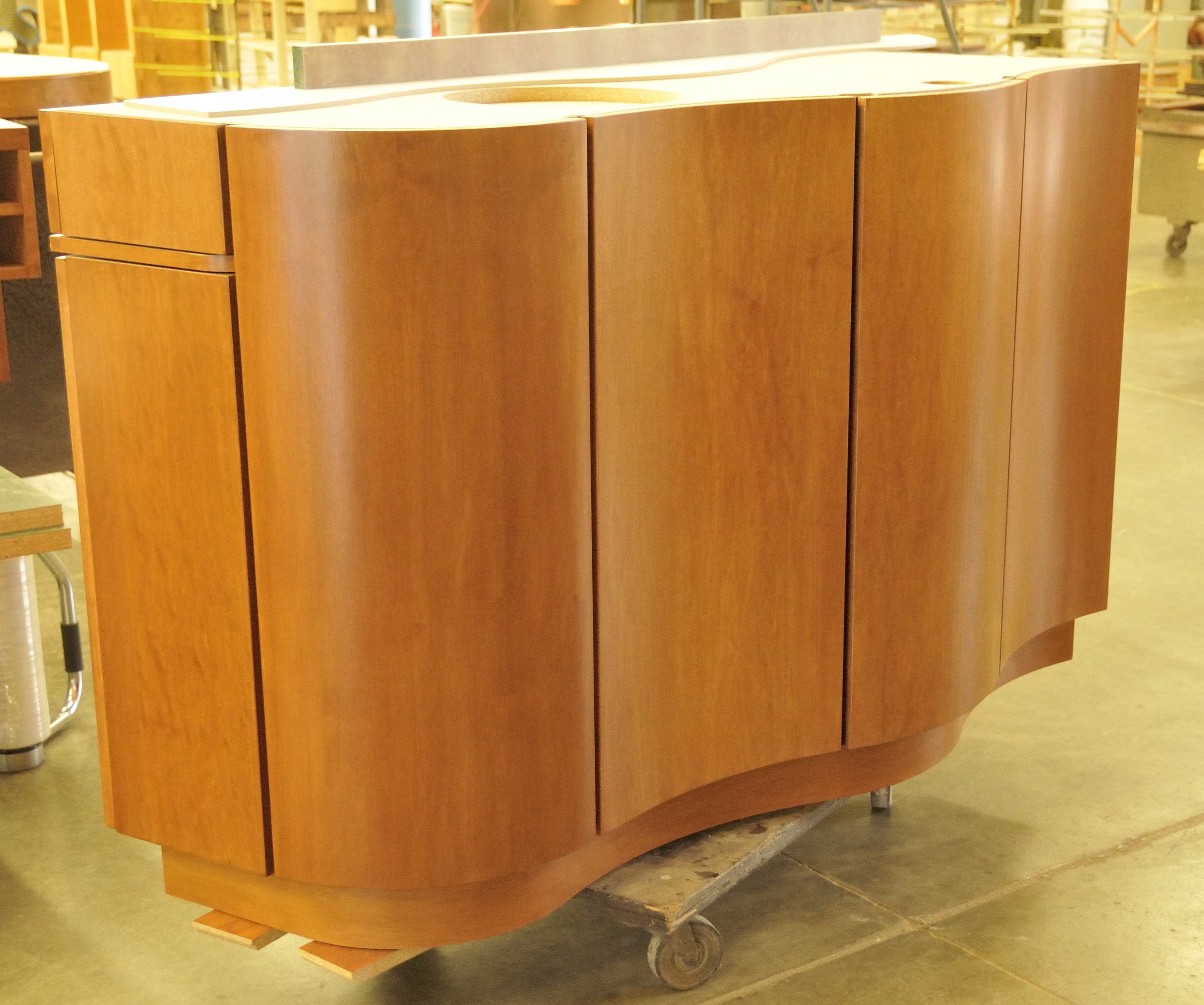

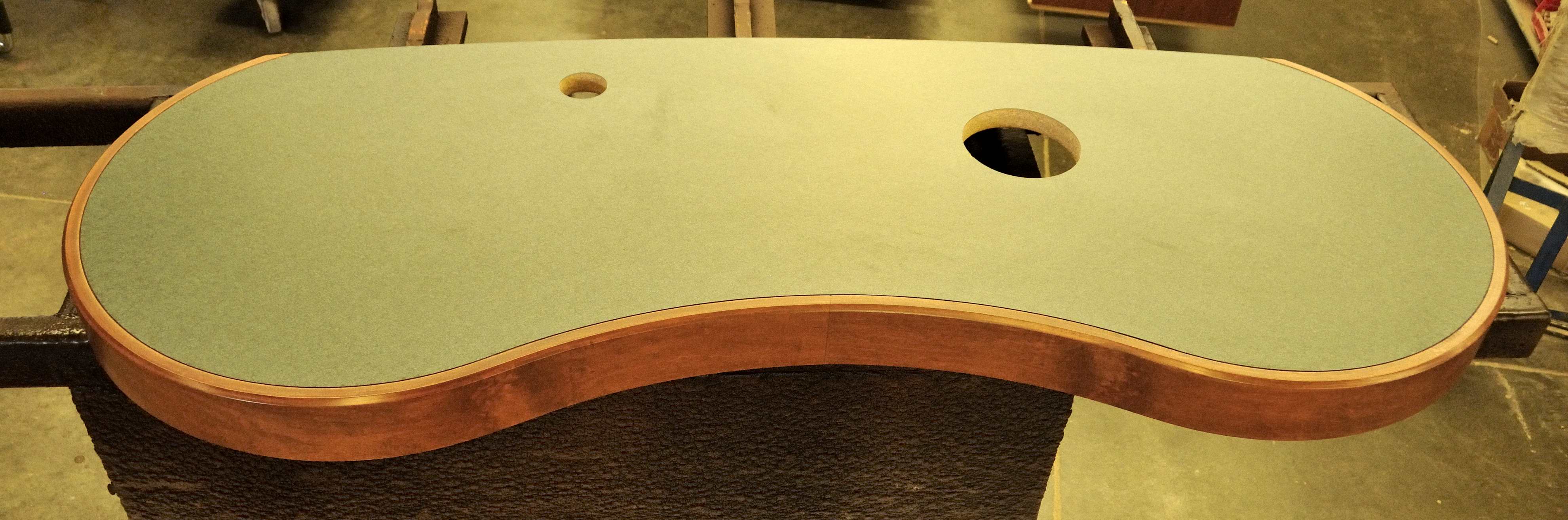

Once up on a time I had a very small business. Just barely eking out a livening. Got tired of it, started keeping accurate records to determine where I made decent $. It was with the trades. Required effort to get known. Had to offer something that was not readily available. Turned out to be short run moldings to match work being done in commercial remodels. I didn't have a molder then. Did it all on a power fed shaper and hand ground knives. I wasn't set up well enough to compete in the kitchen business and didn't want to spend the time working with home owners. I currently only do commercial work, No advertising at all. Just have become known for the ability to do designs that most shops in the area can't or won't. Lots of curves!

Steam bending the edging on that top?
10/13/15       #14: Marketing Not Working ...
Bent laminating. Tricky to control spring back though.

Nice work. What type of glue is giving you spring-back?

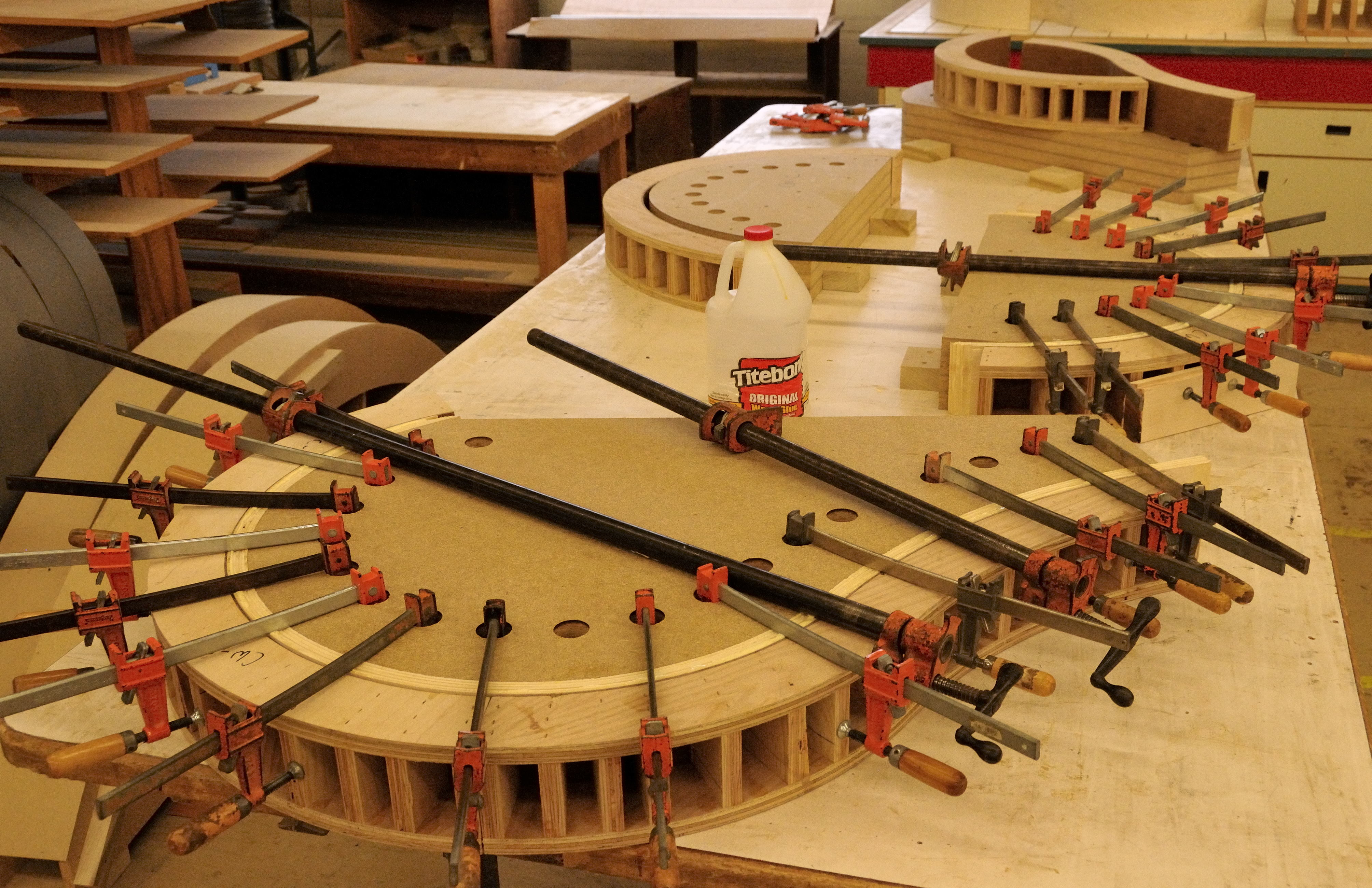

10/13/15       #16: Marketing Not Working ...
We use Titebond in spite of the fact that it is subject to some creep. Spring back can be controlled by using the correct lamination thickness. Too thick & it springs outward. Too thin and it will pull inward to a tighter radius. In the past we had used plastic resin but it is so brittle if there is any place where there is a bit of glue line thickness that it wasn't worth it. When we need to do exterior work we use resorcinol. Great glue, totally unforgiving and no good for clear finished work. I've got some furniture at home that was made 30 years ago with bent laminations using Titebond, still fine.
If anyone is reading this that is new to lamination remember, your mileage may vary!
Notice in the glue up photo that there is a rigid form on one side and a slightly flexible form on the other. That allows for minor variations to be taken up & still get tight glue lines. Timing is critical, the glue must still be wet, everyplace, when the final clamping is done. We had 3 guys on the glue up in the photo. The layers are laid edge to edge and held together with some screws next to the edges. Glue is rolled on using a synthetic glue roller (not a paint roller.) Don't put too much glue on or it will cause problems by holding the work apart and may not allow the laminations to come together soon enough. Curves are our niche, we do them constantly.

Thanks for the detailed response. I found it informative and counter to what I would have expected regarding the plastic resin. However, I am not going to debate what I know from "theory" against your actual experience. I learned something important. Thank you!
And, 3 guys on the glue-up. That makes perfect sense with the relatively short open time of Titebond (as compared to the resins). The more I look at the photos, the more impressed I am.
