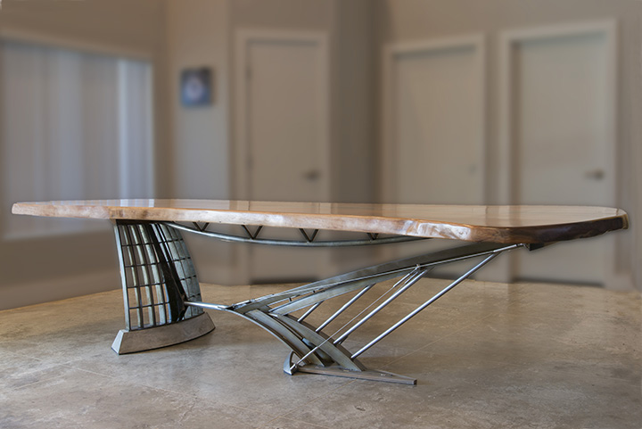

Photo of one I did a couple of years ago.
View higher quality, full size image (720 X 481)
