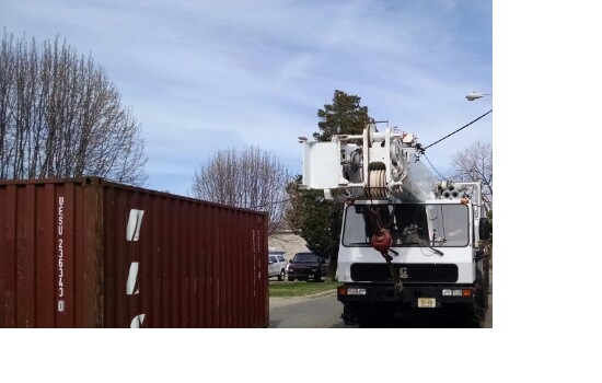

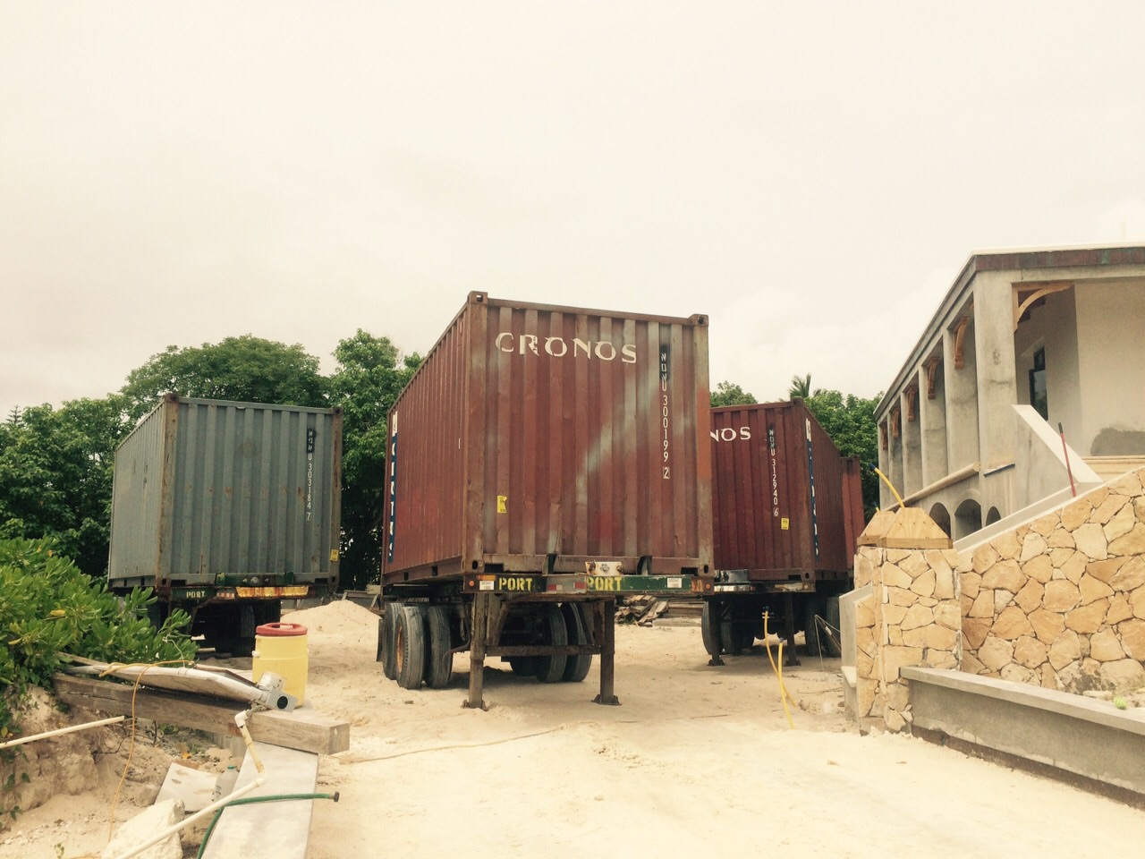

We did a large job in the Bahama's on the Island of Eleuthera this past year.
A Private home in the middle of nowhere.
We are in NJ where the architect is from,that's how we got it.
Most of the job was Cypress or Mahogany.
All interiors were 3/4" Maple Prefin ply.
We even had the granite for the kitchen vanities,bar,& cabana shipped.
While we did not have to handle the transport to the island, we did have
the customer get 2 -20 ft shipping containers dropped off in front of my shop.
That took us 3 weeks to load and secure. Then a crane loaded them on a custom flatbed truck to the Port of Fort Lauderdale.
At the port Seacor Shipping took over Customs and all. Putting it on their boats and getting it to the Island port.
A local Island trucker (The only one on the island )... took it the job site 40 miles south from there. Took about only 2 weeks to get there.
When we got word that they were onsite and all the import taxes and custom duties $$$$ were paid,
2 of us flew down for 3 weeks of install ,sun & Kalik beer.
The once in a lifetime job....
