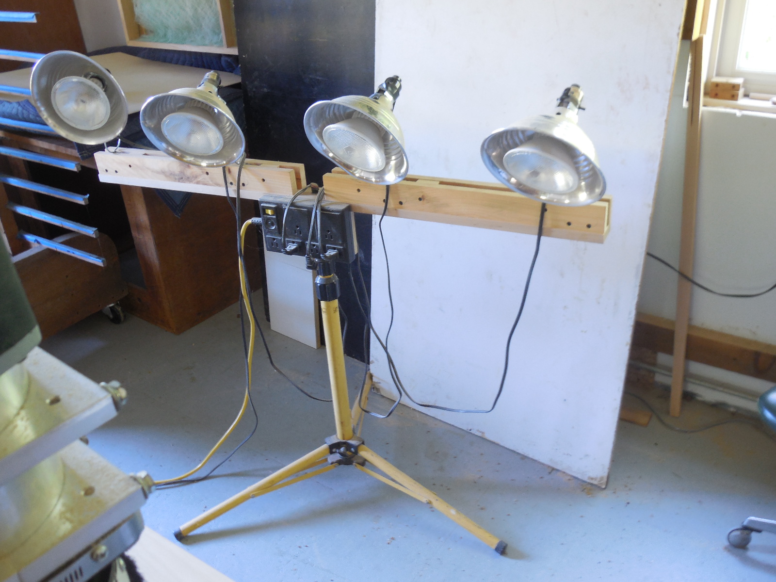

You may already be doing this, but good inspection lighting raking flat across the work can help identify sanding problems prior to stain/ finish. I have a cheap setup made up of led floodlights in clamp-on reflector housings mounted on a height adjustable stand. Carter makes some more professional setups. I don't know if you could have caught the fingerprints, but it can help spot dents, holidays, swirls, etc.
The key is someone has to be paying attention- maybe the inspector should be the finisher as he is the last guy in the chain and doesn't want to waste his time buffing turds. I know at my last gig nobody wanted the finisher to pay them a visit saying "You got a minute? I want to show you something."
