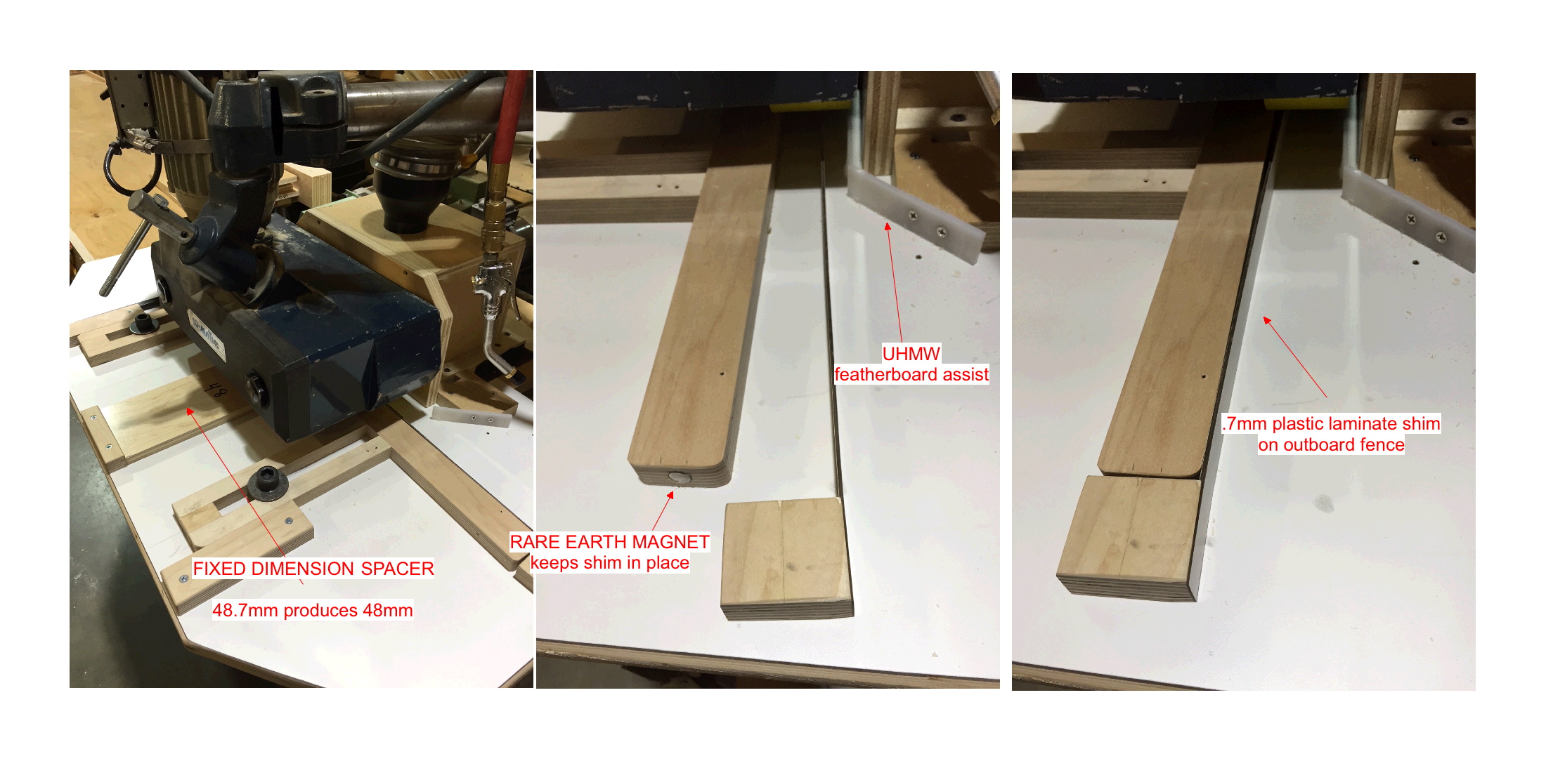

There are two differences between our custom shop and most others. The first one is that we are the designers for every project we produce. We are 100% retail. We evolved to this position from a background of being Winston Wolf in Pulp Fiction. It was our job to identify all the snakes in a project and kill them in a way that made the architect think it was their idea.
The second difference is we are committed to continuous improvement.
We are always improving either something in our product line or the process we use to produce it.
On our last project we changed how we shape face frame parts to dimension. We added a powerfed shaper with a 4 inch tall tersa head. The dimension indexing is set up via a library of positive stops. The stops are calibrated to produce a finished product that is oversize .7 mm.
Our widebelt sander has a limit switch to that stops elevating the bed when the lumber comes into contact with a sensing switch. The first pass removes a consistent .5mm. The sander also has a button that allows you to recalibrate in .2mm increments. This is how 50.7 at the shaper always produces 50 sanded both sides.
The primary difference between using this system with a complete greenhorn and a master cabinetmaker using what ever cowboy method comes to mind is that our parts are always accurate to dimension and take only half the time.
We use this time savings to improve our product line. The kitchen in our shop this week is getting a combination cookie tray / pot lid on the back of the door cabinet. It's a new combination for us and will be blog-worthy.
