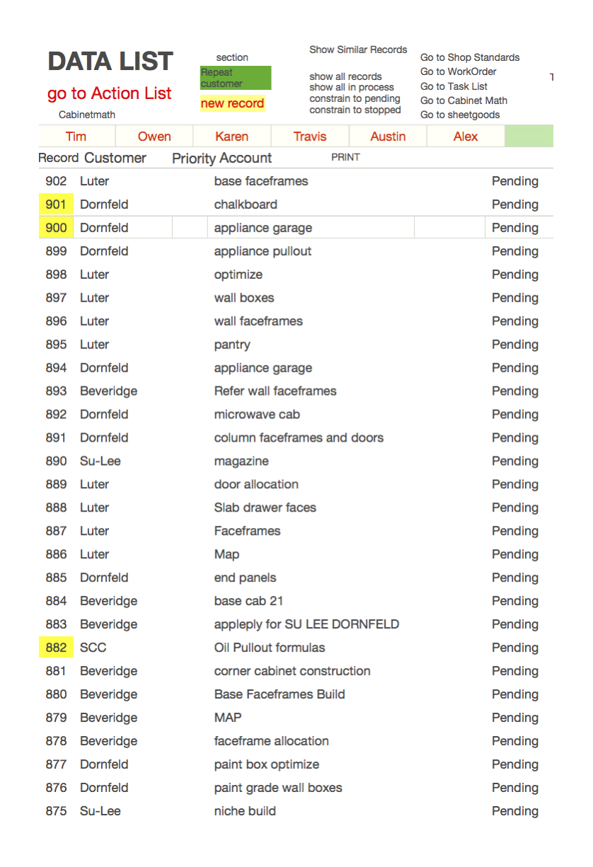

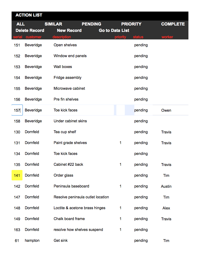

Here is a mechanism we use to park information and communicate status at my shop.
The first image is the ACTION REPORT. This is punchlist we use to drive the shop. I run my end from an iMac at home. The feedback loop is an iPad at the shop.
The action report just manages activities (common etymology with the word "action".
The second image is the DATA LIST. This is where we store all things that need to be retrievable or archived. It's kind of like dropbox but is sortable. We can select a customer or topic and parse it out so that just that customer or topic is presented. This ability to filter creates a smaller subset of information.
CUSTOMERS are populated from a list of all customers. This field presents only the customers who have a status category ="current".
The values on the far left of the screen constitute a button that takes you to a screen germane to all things that cabinet.
By numbering the record we can talk quickly about item 930.
If these values are yellow that means there is also a memo. They can leave a memo on their end and I can leave one on mine. If you see yellow this means investigate.
We also make use of text and iphones to discuss.
View higher quality, full size image (846 X 1080)
View higher quality, full size image (838 X 1225)

I forgot to mention that these ACTION REPORTS & DATALIST are accessible from anywhere on an iPhone or Android device.
You can update a memo and/or access an PDF document directly from these reports.
As I said before, this is not necessarily adding extra tedium. You already had to have some way to hang onto this information. If you do it electronically more than one person can have access to and/or be able to update the information remotely.
Computers compute.
This frees up RAM for the manager to manage.
