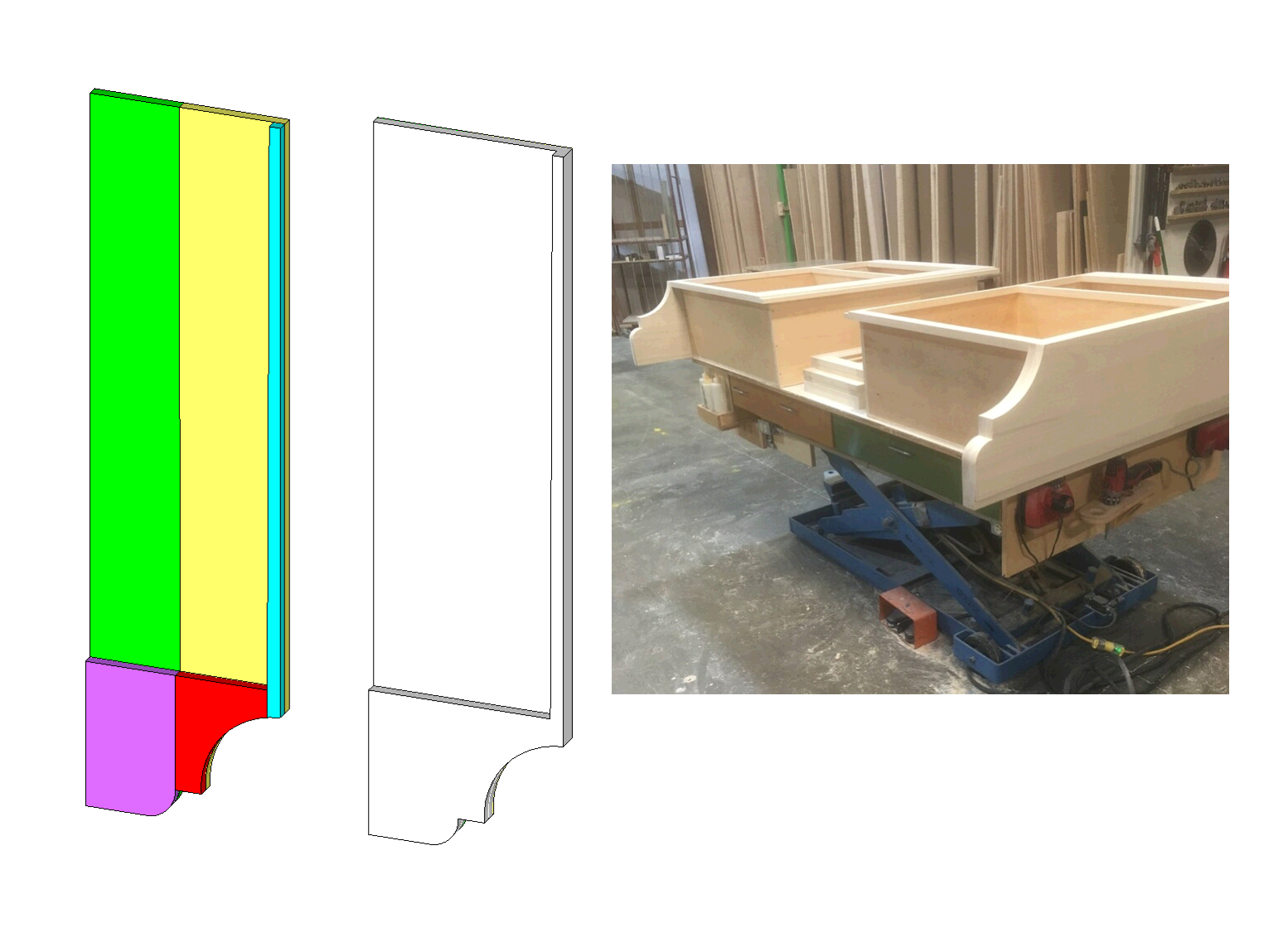

The attached drawing shows some curved end panels we built. The customer wanted us to match something that was built 80 years ago but wanted the interiors of the cabinets to be pre-finished. When the work order came in I wasn't real obvious to me how we should approach this. I had never done a cabinet like this before. I was confident, however, that I could probably noodle it out on paper and better understand how the parts should come together. The color coding helped me explain it to the fellow who actually did the hand work.
Sketchup has helped me figure out interfaces many times in the past. It does take a small learning curve but the payoff is significant.

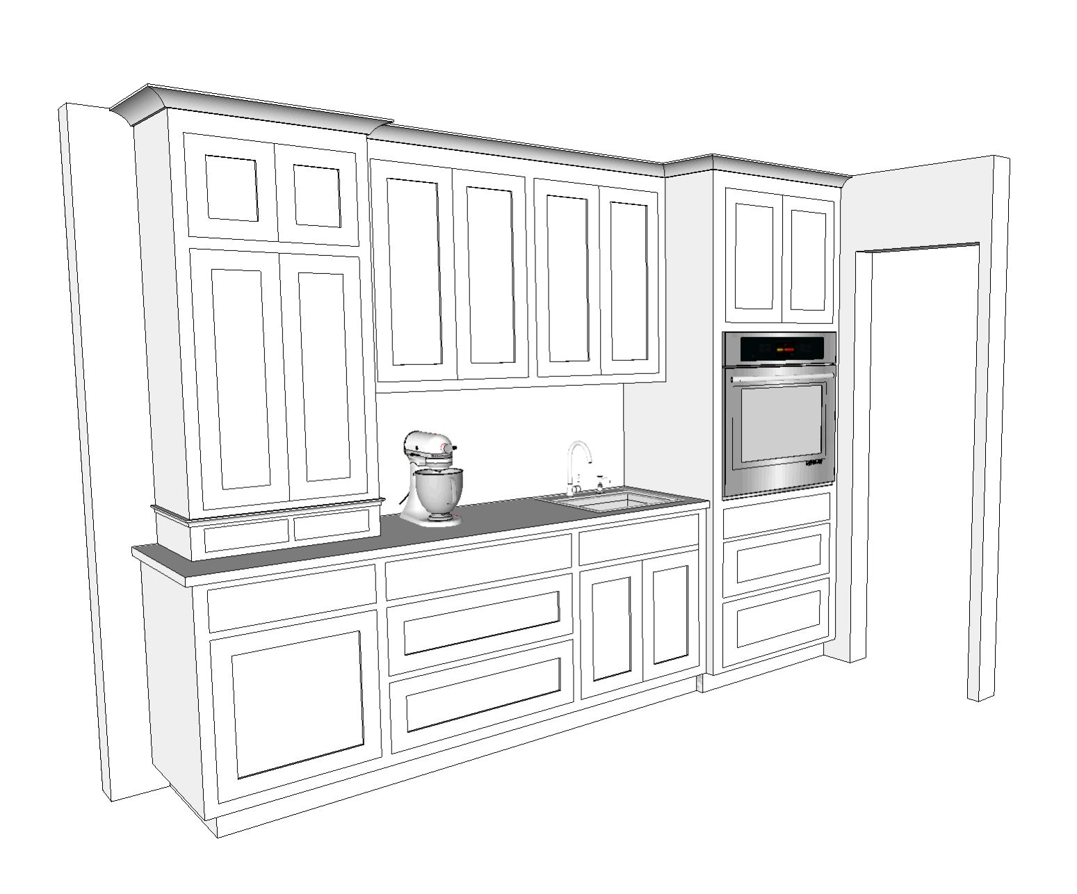

This is a drawing of a baking center that I know is important to the man in this household. He bakes bread a couple of times a week and he uses a white kitchenaide mixmaster.
The lady in the house mentioned that she liked column cabinets that come all the way down to the counter. She also has a lot of colorful mixing bowls that she likes to have on display.
I will show them this drawing with a version that has glass doors and one that converts the end panels from flat facets to being framed like the cabinet doors. I will likely also show a version with the oven below the countertop.
I am trying to get three things to happen here. I want to have a way to talk about budgets without talking about budgets. I want to figure out right away how important it is to have the oven at eyeball level so that my subsequent design work is more relevant and I want to get the customer to connect emotionally with the space and with my company. If I can get the customer to develop confidence in me and my ideas I will have a better chance to steer the job to the outcome I want to have happen.
These drawings will eventually make it to my website where I can amortize these efforts over more customers. Think of this (in a small way) like Toyota selling you a car then selling you some tires then offering you a discount on airline tickets if you'll use the "Toyota Club" credit card for meals once you reach your destination.

I use tight bond Type 1 and plenty of it. We never have a glue starvation issue.
After the glue hardens we run it through the planer on both sides to about 28mm. This gets the glue down to where you can start working it on the jointer.
After it goes through the planer we let it set for a week or so. We always have some of the laminations in the pipeline so waiting time is about non-existent)
You want to make sure that all of the moisture added from the glue is out of the board. It helps too that the staves we started with were initially ripped a couple of weeks earlier by our supplier. Gives the board a good chance to better acclimate in smaller pieces.
We fixed the stain grade problem at the marketing phase. We only build paint grade cabinets and somebody else paints it. Somebody else delivers it and, come to think of it, for the most part somebody else drills the handle holes. I think we have drilled handle holes for maybe four jobs in the last ten years. We had a recent rash of requests for this so I bought a pretty super duper fixture for this. One of my friends who has his own shop showed me his and I was sold.
