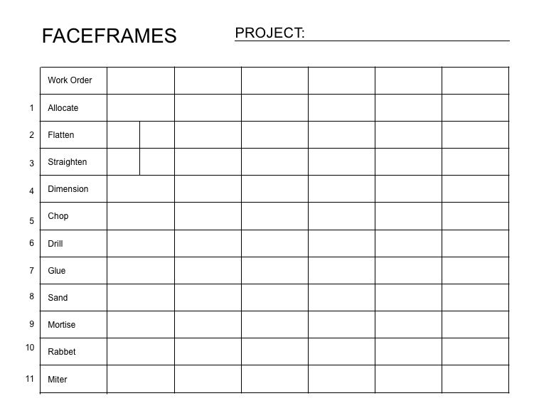

The attached chart shows the basic stages for a faceframe at my shop. The faceframe represents the basic batch size for anything we do. It defines how big the package is when we lift it off the bench, onto the truck and into the house. The package at this level contains everything that it needs and nothing that it doesn't.
Think of a chart like this as being similar to how you would want your auto mechanic to diagnose what needs to happen.
Numbering the processes allows for concatenation and certification. Concatenation creates the Dewey Decimal system. Certification is key to understanding status at any level.

I don't know how I would possibly track all those aspects of faceframe production? Would someone have to che check each box on a digital device at each station or carried along with the individual?
It would seem several of those would be combined in the face frame guys workflow?

However, if I came to work for you and saw that chart (with no slots for urination, sneezing or butt scratching), I would run. Away.
I can think of no more soul sucking thing that would drive all the joy and passion out of a human, their work and their life. You will end up with mindless automatons in a few months. Or maybe an empty shop. Is that the goal?

How you can jump from a chart that merely indicates status and sequence to "soul sucking" absolutely escapes me. When you come up to a stoplight does your brain start wrapping around existential issues of free will & determinism?
My shop is staffed by a lot of people who aren't in the building at the same time. Many of them don't even work on the same day. How would you pass information from the Sunday guy to the Tuesday guy?
Is he supposed to walk around and look for clues? Do we rely on burma shave signs? Little notes written on plywood sitting on top of piles?
We usually have a dozen work orders underway at any given time. Each work order has a dozen possible statuses of completion. In your utopia how exactly does the Tuesday guy know whether or not the shelves got cut? Is he supposed to look around for clues then build his daily strategy based on those conclusions?
For the record we don't have a time clock. Our worker's schedules are a plus-minus half hour start/stop time. We don't have formal breaks. There is no buzzer. You go to bathroom when you have to pee. If you're hungry you eat. If you want a cigarette you go smoke one. If you forget your lunch you go over to Trader Joes and get a burrito. If your dog needs to go to the vet you take him to the vet.
How you think this is incompatible with crossing putting a check mark next to indicate field position baffles me.

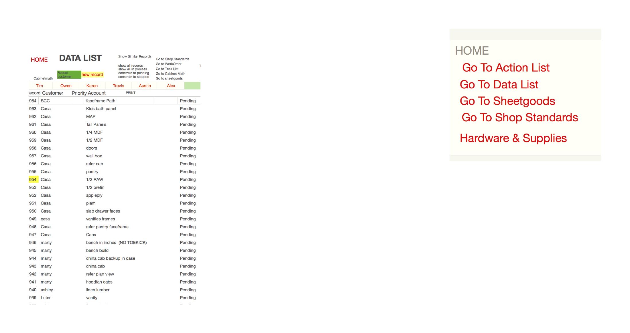

We communicate with iPads at my shop.
If you think of something that needs to happen you need to order you can update any of these lists from anywhere in the world with a smart phone.
The software is called "Central Scrutinizer". (I am sure David will like that one.)

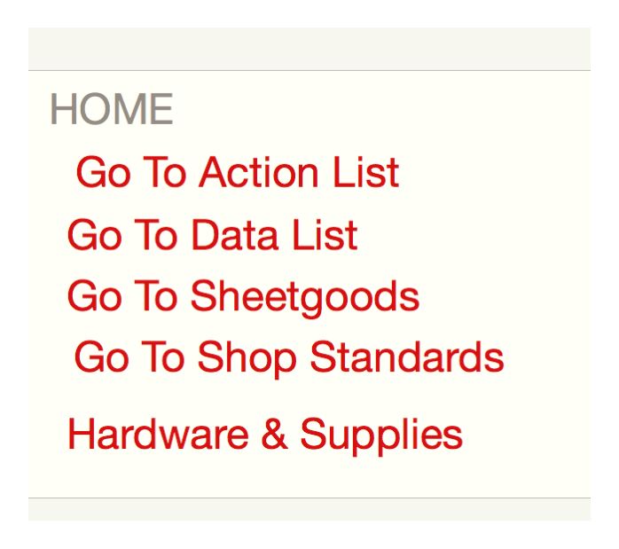

The first jpeg is HOME. It's the jump off to everything else. All of the shop drawings are parked on the DATA LIST. the SHOP STANDARDS list contains drawings of unique items. If you need to know the minimum size cabinet that will accommodate a Hafele Magic Corner you will find those notes here. We make pencil drawings in our shop just like David does in his. We just store them for easy retrieval in this soul crushing database.

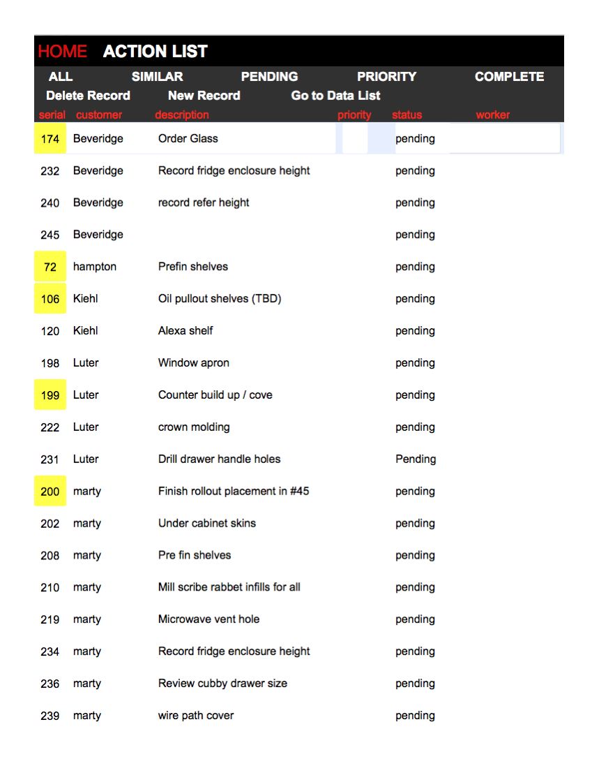

The second JPEG is an ActionList. This is how we track ad hoc work orders. If you need to remember something write it down.
Numbering the list makes it easier to find and talk about a task. If you see a number in yellow that means there is a memo behind the number. Click on the yellow to get more information.
Notice that the customer's names are in no particular order. We enter the projects randomly throughout the day. If you want to know anything else about any job you select a name and hit the "Similar" button. This will bring up everything on the list germane to that customer.
If you write it down on a database you can link it to a video on youtube. There is no reason for a greenhorn to have to get beat up for ten years before he can acquire enough skill to make a living. That's what YouTube is for.
Chordal wrote something about how to produce durable, retrievable information. He was advocating for linen stretched over pine boards.
Today we have iPads and Cellphones.
