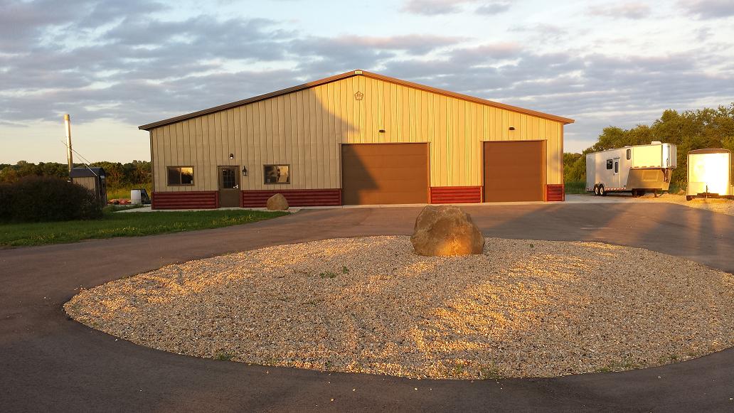

I built my shop in 2012. One man shop 66' wide X 40' long pole building with a raised cord truss to gain a little extra height in the middle of the shop. Built it wider then long to not effect the neighbors view when I add on. So far i have been extremely happy with the building. Mine is located on my land where my house is. We went threw all loops the permits and zoning changes to get it zoned properly. Have dedicated space for office, bathroom, spray area, finish mixing storage area, and a portion of the side to park truck, skid steer and holds air compressor/dust collector. I did infloor heating and spray foamed walls blown in roof. Well worth the extra cost Only thing i would have done differently would be to sheet the outside of the building before puting up the sheet steel. We had hail damage and had to get it fixed. Alot more work getting steel off and trimming foam to fit the new sheets on the sides of the building. Also the foam pushes out a bit on the steel causing a bubble look was kinda pissed after they sprayed it and thats what you see when you drive up to it. I fully finished the interior. 8' steel on exterior walls in the shop areas and drywall on the rest of walls as well as the ceiling. I did this also for resale if we ever sell. Rather then steel on the inside or just seeing the white insulation. Whatever you end up going with think ahead for future add ons and machine placement changes.
View higher quality, full size image (1032 X 581)
