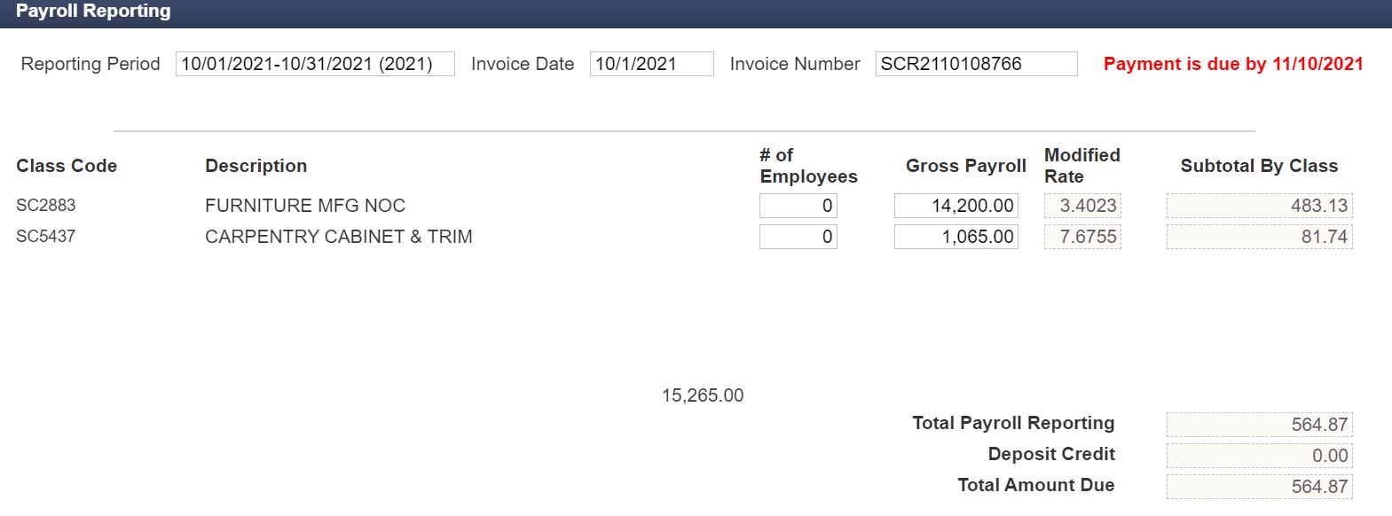

james e mcgrew  Member
I have WC through a state Home builders Assc. even though I do not do residential.
there portal breaks up my rate for shop (lower) and install (higher) here is an example i filled in so you can see it. our payroll is a lot higher than this
View higher quality, full size image (1569 X 582)
