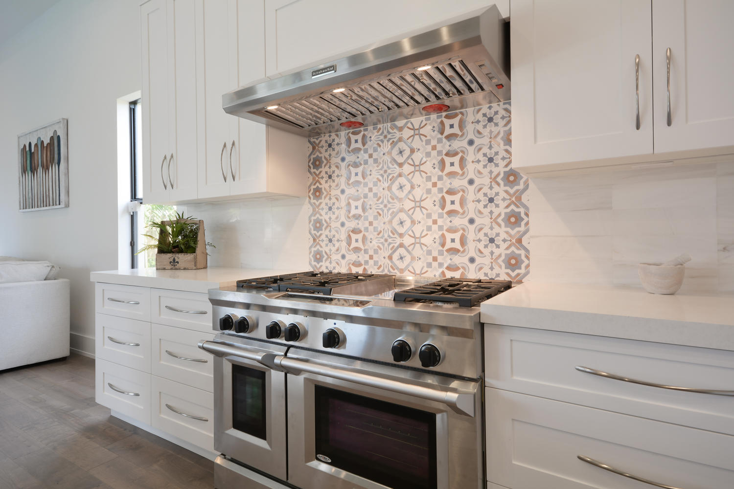

1mm matching banding and white glue.,try to minimize glue thickness and don't go too deep on the trimmers. It's better to do some handcfiling then bite into the surface even a drop, clean with fresh rag and spirits.
The only way to a perfect edge is to have an airtronic or laser Bander which is out of range for most .,harold.
