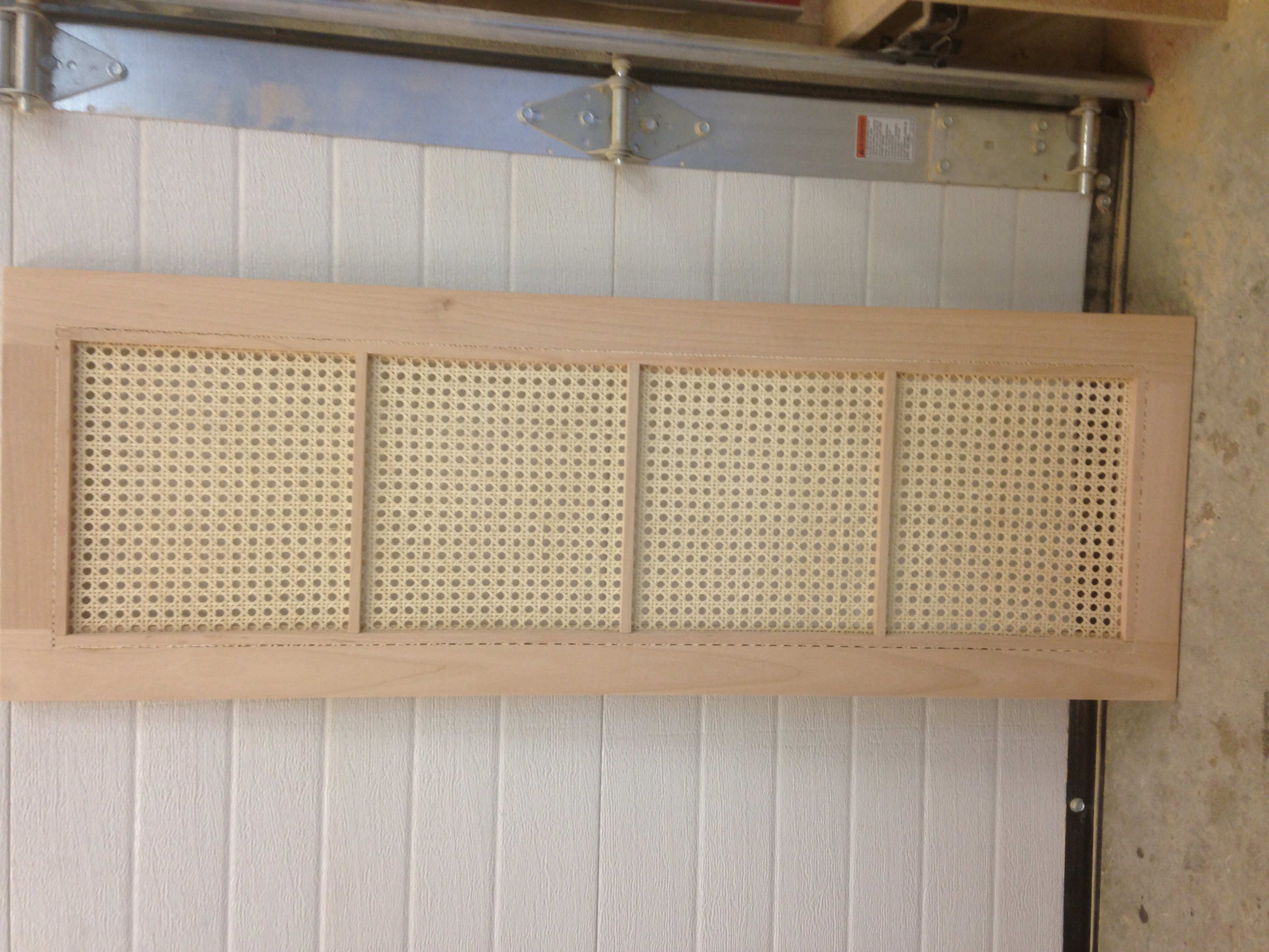

I've been getting requests lately for woven cane panels in door & end panel frames. I did the first 2 on the ends of the pictured wine cabinet. They came out ok, but I wasn't quite satisfied with how tight I was able to get the cane stretched into the frame. I put the cane into a rabbet on the back side, stapled into place with one guy helping to stretch, then put a 3/8 x 3/8 stop on top with a bead of hot glue and 23 gauge pins. I'm sure there are better ways to do this.
I have an upcoming job with 8 cabinet doors with this detail. I would appreciate any advice on a better method. Thanks!

Update: after some more trial & error, I was finally able to get a good result. What I kept underestimating was how much the wet cane shrinks, and how much force it applies to the stops and the door frame itself.
My first attempt, with dry cane, I was unable to get the cane very tight.
My second attempt, I tried wet cane slipped into a 1/4 x 3/8 dado. I pushed a spline in and pin nailed in place. It looked good, but the next day when it was dry, the cane had shrunk out of the dado leaving the splines in place.
My third attempt, I rabbeted the back of the door frames and held the wet cane in place with 3/8 x 3/8 stops, yellow glue, and 23 gauge pins. This almost worked, but the shrinking cane partially pulled out some of the stops, shrunk out of the frame, and was unusable.
On my fourth try, I used more glue and stapled the stops in. This finally worked to hold the cane and stops in place, and the cane was tight as a drum when dry. However, on the two 42" tall doors the shrinking cane pulled the stiles together in the middle a 1/4". So I got the cane wet again to relax it and spread the stiles apart with three more of the 3/8 x 3/8 stop material to act act as stretchers. This finally gave me an decent result.
If I had to do this again, I'd use 1 x 3 stock for my stiles and rails, and put a center rail in any doors taller than 30".
