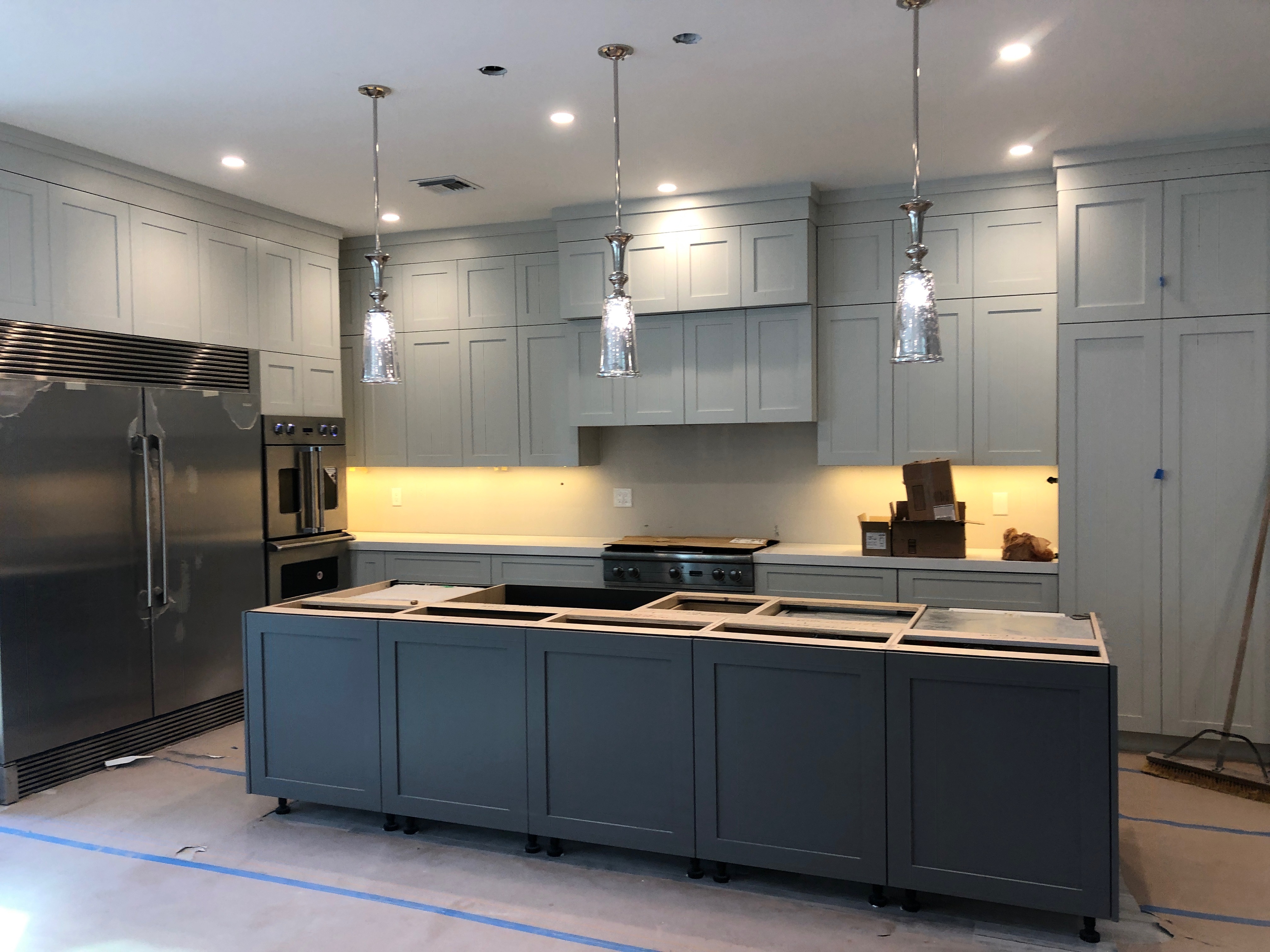

It's one of the reasons the European designed cabinets sit on metal legs. You get easy adjustability, but you also get 6 pcs to a sheet. Claimed to have been put into use right after WWII.

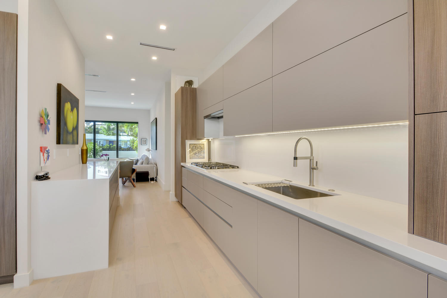

We build frameless Euro Cabinets andvhave been using the euro legs fir 20 years. 6 sides to a sheet, easy registration for double line boring and way faster to install than ladder. Toekick gets clipped into legs or screwed from inside drawer cabinets and seperate endcpanels so no Cabinets go to Finisher, just doors, drawer fronts , endpanels and fillers, we use Blum inserts hinges that are snapped into door on site to minimize transport and damages.
