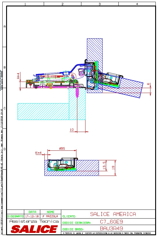

Hello Door Shop Guy,
Sorry, we do not offer a 1/4" one piece soft close. Ours begin at 1/2" overlay and go up.
The only 2 options we can offer is a 2-piece hinge and mounting plate or a 1-piece with the add-on Smove damper.
Here is a drawing of the 2-piece soft close for 1/4" overlay.
Please let me know if you would like samples of either.
Thanks,
Dennis
View higher quality, full size image (552 X 810)
8/25/19       #3: Salice hinge question for Dennis Be ...
door shop guy
I found it in Grass and ordered from Baer.
Its not a popular hinge because you can almost see inside the cabinet from the side. I would never recommend it but customer wants what customer wants. I would always recommend the two piece option.
