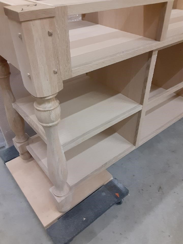

A customer out of the blue decides she wants the shelves on this island as well as the sides in all solid wood. Here's her quote, "I understand that can happen. But we do need solid wood shelves. It will crack from any moisture and this will see heavy use. An exposed shelf cannot be protected with plastic like the inside of drawers. We have had an oak dining table that was veneer and it doesn't take long even with every precaution until it cracks. We will never buy a table that is not solid wood again." This came about because she was asking why the samples we provided for stain looked different on sold wood than on plywood. I told her that solid wood can stain differently than plywood. When she does finally decide on a color we'll make it stain evenly. Previously she had wanted us to rub through parts of it, to copy a bench she brought in that was old and had worn stain that was all over the spectrum as to dark and light. This is her design, the way the shelves attach to the posts etc. At know time did she tell me she wanted all solid wood. Here's my question, with this design is all solid wood, a good design in regards to the joinery? This is one of those jobs I should have not taken or had the customer provide drawings with dimensions on every aspect of the entire project, which is a kitchen remodel. Micro managed down to the size of the scratch on a distressed door.

Shelves usually don't get the same wear as a table. A table gets hot and cold, spills, kids, and life in general.
If the oak veneer table is cracking then maybe there are wide changes in humidity or temperature, or if it was custom made, maybe it was poorly made or finished. It is also possible that they put very hot plates or platters right on the veneer.
If the issue is temperature and humidity solid wood will be worse.
The sides are protected by the overhangs
Explain to the customer that its difficult to change now but that they can protect the wood by using a more durable finish.
There are plenty of coatings that will be plenty durable.
Did you do shop drawings or label your samples like wood edge of shelf and veneer surface of shelf?
I think the solution is a proper finish if the issue isn't the indoor temperature and humidity. You need to understand why the oak table is failing to address the problem.

Maybe you could figure out how to cover the open shelves with a wood overlay or a shelf on the shelf ? Communication is key, best wishes.
