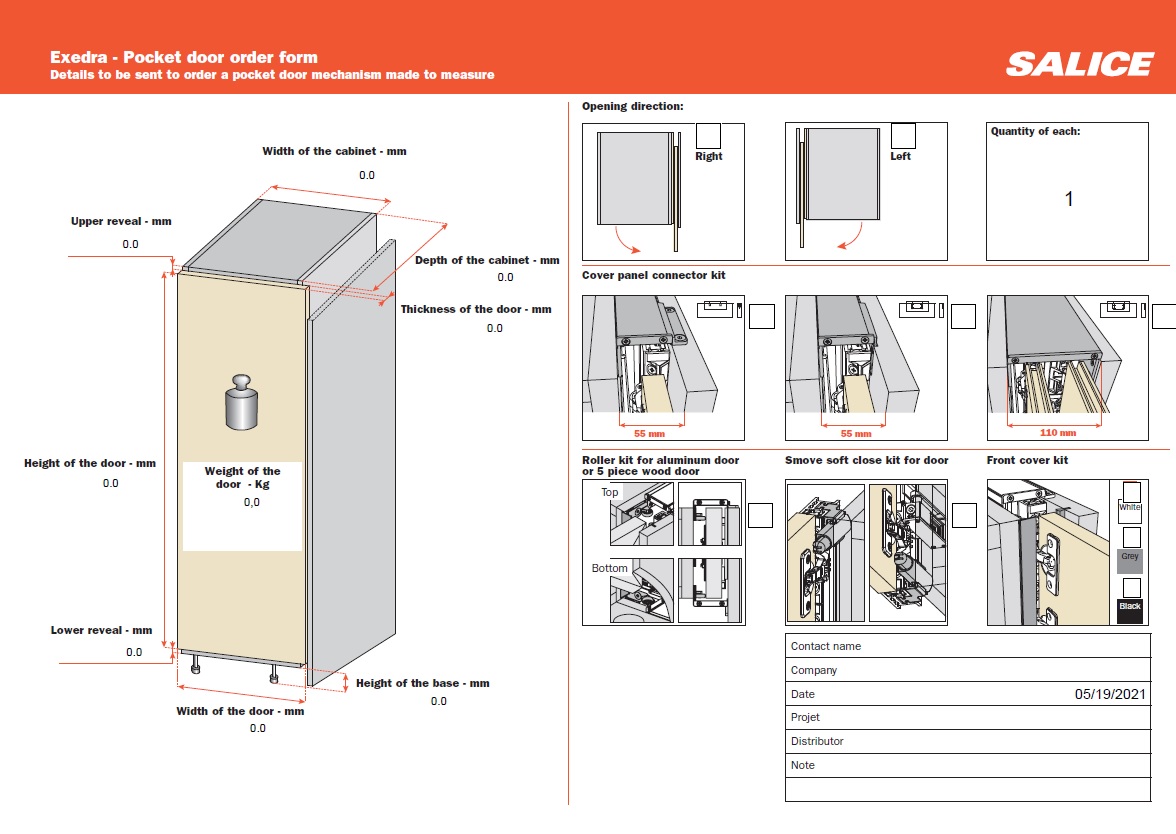

Due to the nature of a pocket door movement, Push is not available. The door would need the handle to open the door then, then when pocketed into the cabinet, the soft close feature brings the door to a silent, smooth stop.
The handle would still be necessary to pull the door from the cabinet pocket. The soft close feature then returns the door to the closed position. Here is a short video illustration this.
If you still want to proceed with Excedra, please send the actual measurements of the door.
Attached also is an Excedra order form that we will use to determine the suitability of Excedra for your project.
We can send this form to you to complete.
Regards,
Dennis
