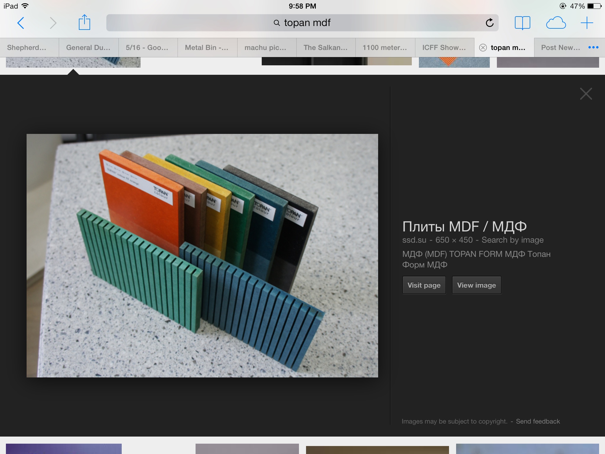

I would like to make a simple drawer box using thru color mdf called topan Can anyone recommend the ideal construction method and finishing?

Looks to be Chinese advertising, this method is used often these days.
Color thru HDF can is sold by Interlam called Valcromat, I have used it plenty !
