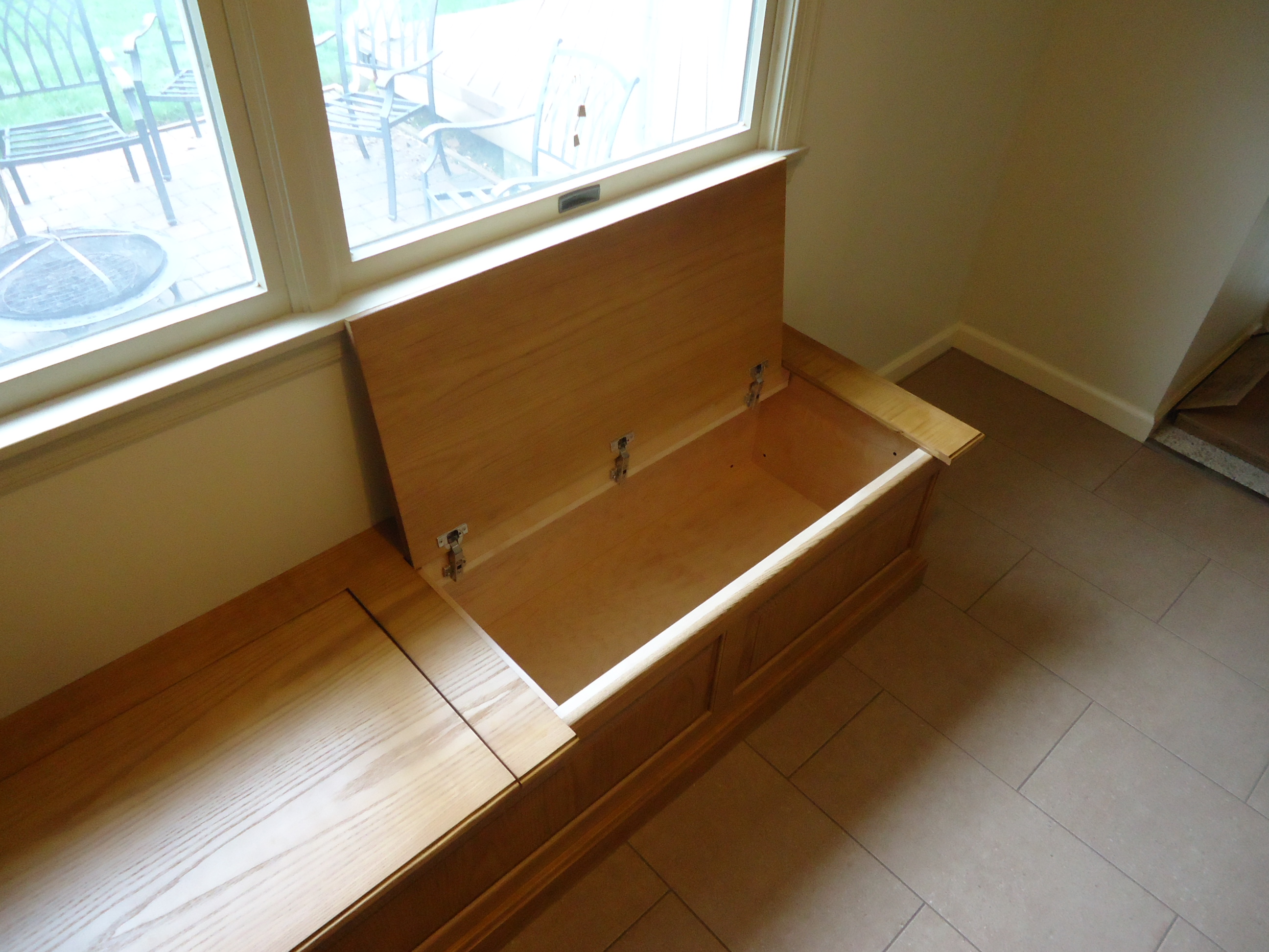

Although I am not an expert on them I did need to do two this last yr. The 1st I did with a piano hinge and hafele lid stays. but for the second I was looking for a setup that had some adjustability so I used a std. blum 1/2 overlay hinge and it worked great. I have support all around so the hinge is not supporting the weight when it is closed. Although I used a soft close hinge it still closed to hard so I plan to go back to install a lid stay. I plan to keep using this system.
View higher quality, full size image (2304 X 1728)
3/24/15       #5: hinge for flip up bench ...
nicko
thanks Mike for posting the pics.
