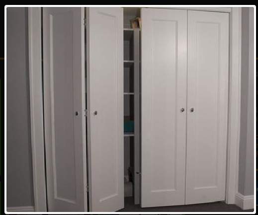

I have a customer who's requested some folding closet doors, 3" wide frames, flat panel, 2 panel doors per side 84" in height. total opening is about 7 feet. The doors will be painted white, frames will be poplar, and interior panel probably 1/2" MDF. Because of the vertical length of each door, Im concerned about the frames twisting a bit, is MDF the best choice for the panels and should I consider another species for the frames? thanks for any insight you can provide. See picture for example.

Poplar frames with MDF panels should be fine. The doors if they do twist any will still be held in place with the alignment tabs screwed to the back of the opening edges of the doors.
