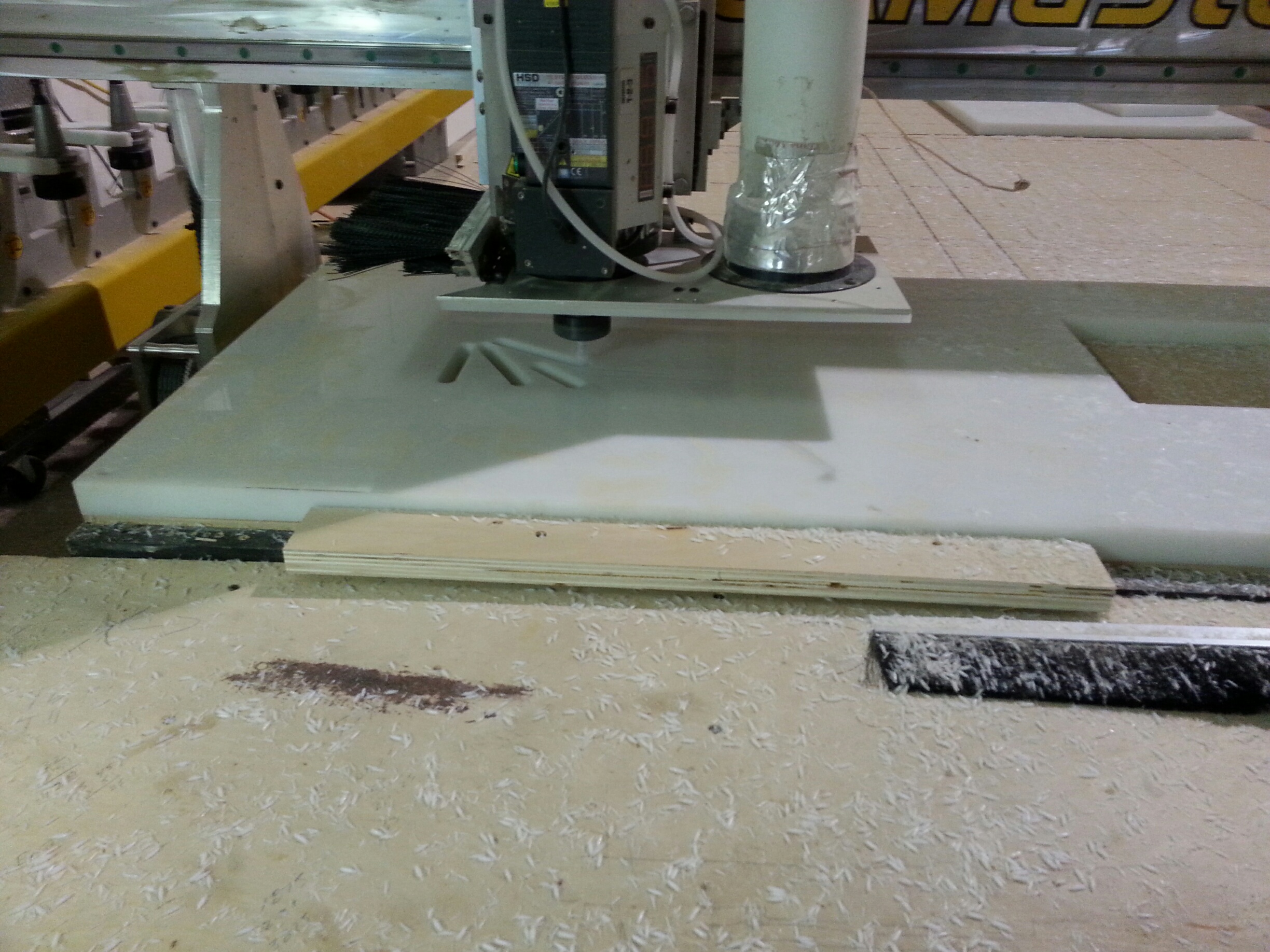

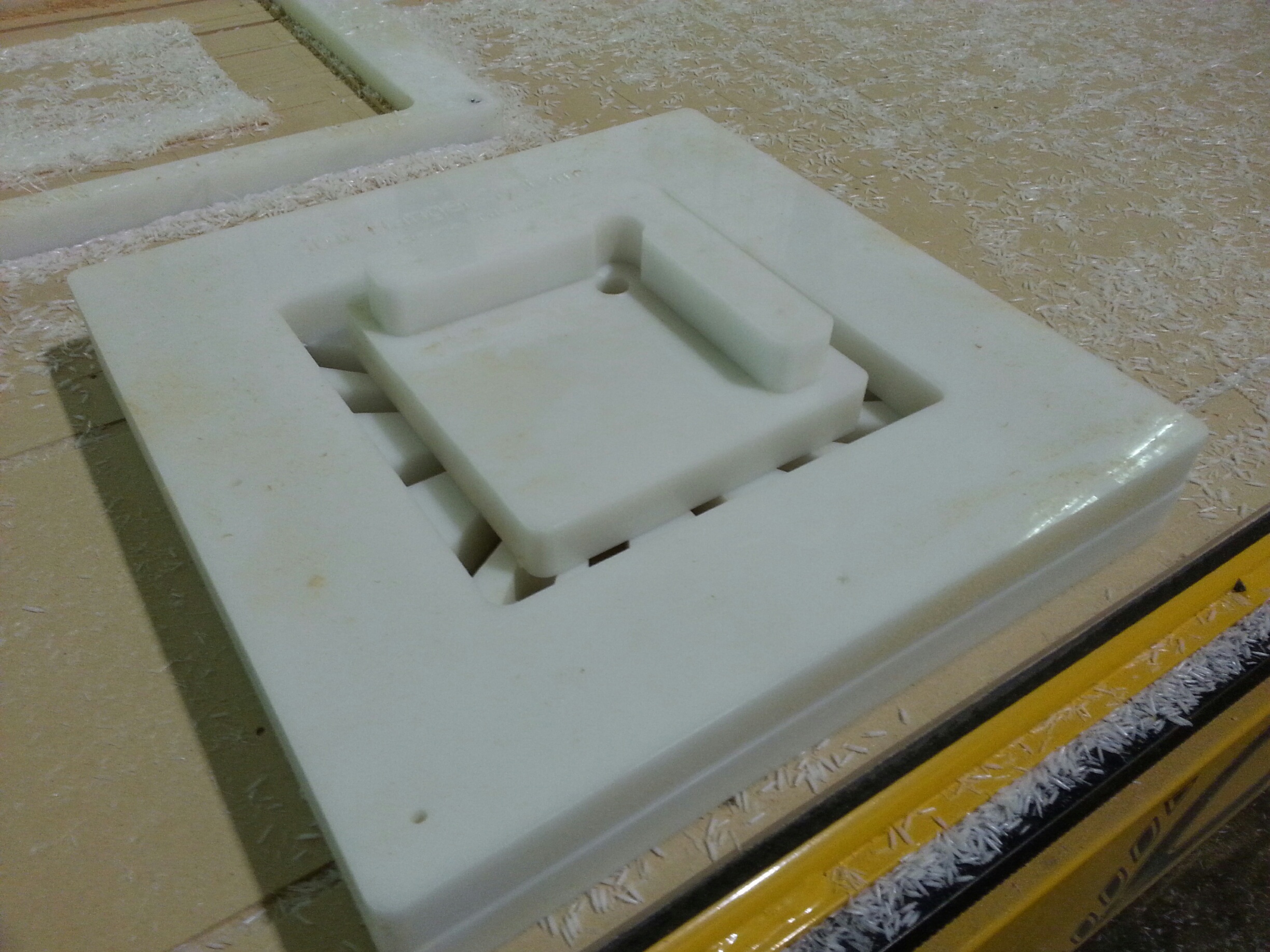

james mcgrew Member
Use lower rpms like 10-14 k speeds at 400 + this was done with .25 up spirals 2 flute but "O" flute will work better.
I cut .1875 holes, pocketed and profile cut this yesterday,, Not the chips on the table.
this was Uhmv (UHMW Polymer (plastic) is a linear polyethylene with a molecular weight in the range of 3,000,000 to 6,000,000. This value represents the "average molecular weight". Therefore UHMW is 10 times heavier than regular high density polyethylene.)
and starboard is similar
View higher quality, full size image (2448 X 1836)
