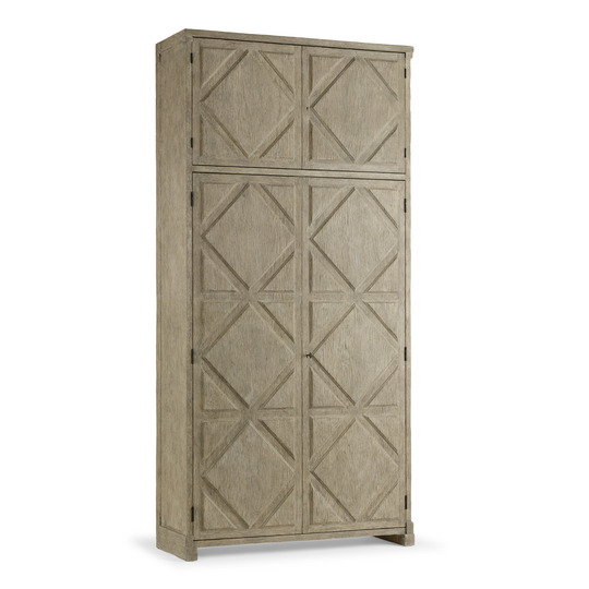

I have been asked to duplicate this door detail of a favorite furniture piece but am concerned about warpage. The 26" wide doors are flat (rift red oak was requested) with the triangle/diamond raised panel areas on the surface. My thought was to make them as 1 1/4" thick slabs and then cnc the panels to shape right on the face of the door. If the panels protrude approximately 3/8" from the surrounding plane, that would leave 7/8" thickness for the rest of it. Would opening up the face like this create an imbalance and cause the doors to warp? I guess I could also make the raised panels separate (as an onlay) and apply them to the face of a 1" thick PB core panel already laid up with the rift veneer. Or I could do this out of MDF and have a thin veneer applied both sides on a bladder press. Am I thinking right? How would you do this?

I think your last idea is least likely to warp. Also the least appealing, but it would be expensive to have to make twice.

When I was given the job of building some doors like this, I was told they were called 'reverse raised panels'. I built them all in solid wood. These were exterior doors, in a 1950's type style. They came out very well, and I was impressed with the way it worked so well, and how anyone seeing them thought them truly unique.
I'm a sold wood guy when I can be, so I see your doors as solid wood.
Essentially, the 'recessed' areas are the frame, and the panels are panels, but instead of a tongue fitting into a plow in the frame, the panels are thicker than the frame and have plowed edges that fit over the frame members. Alternately, the panels can lap over the frame on the show side, but be recessed on the interior side of the doors in a sort of half plowed, half rabbeted manner.
The panels should float like any solid wood panel in a frame. The frame will carry the weight, and should be stout enough to stay flat, with good mortise and tenon joints, jointed and true parts, etc.
