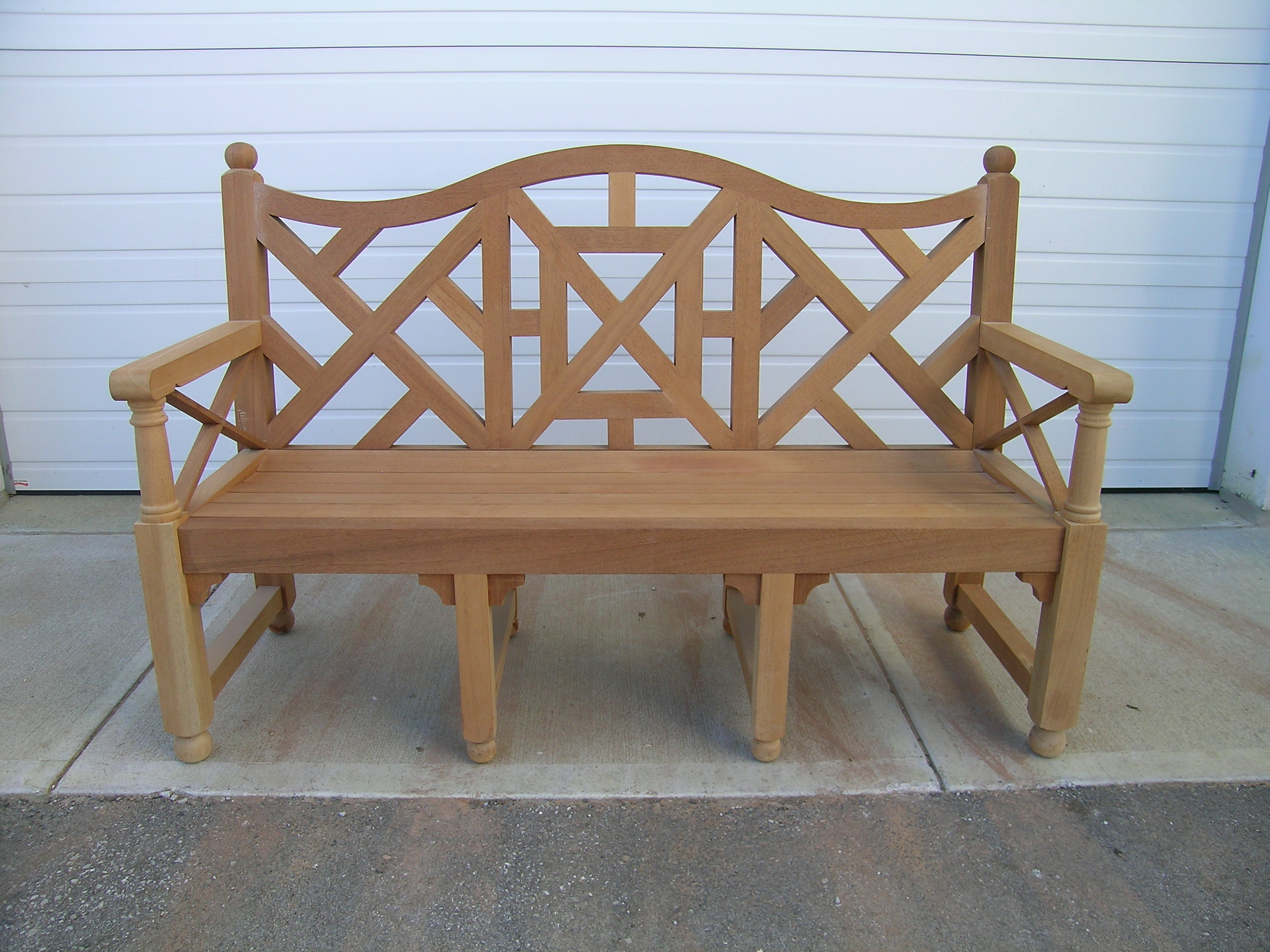

Can you imagine this bench with pocket screws?

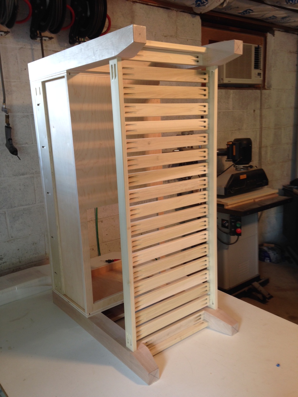

As said, pocket screws have their place and are very useful. I used some in this cabinet and they saved me time and space during glue up and assembly.
Come on out, look, and if you can find them, you win the cup of coffee.
Oh yeah, I laid up the plywood shelves behind the doors with shop cut veneer tape too.
View higher quality, full size image (746 X 583)

As I said before, I use them where they can't be seen. The bench pic above is a good example of when not to use them and the cabinet below it a good example of when to use them,(great looking work by the way). When I first started years ago I prided myself on joinery. Rabbet joints in the back of the sides to receive the back, mortise and tenon face frame joints, etc. It took a long time to build a set. In the end this is what I realized. Only a fellow woodworker would appreciate my time and effort that I put in on making all those joints, plus all those joints got covered up and no one ever gets to see it anyway. I now use pocket holes and save time and then devote that time to things that get seen like design, finish, etc. I've never had a single cabinet to fail in anyway using pocket screws.
