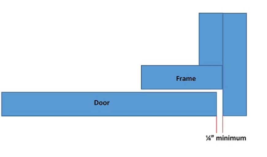

This is a common downside to any brand of compact style face frame hinge. Using a “long arm” Euro hinge and a face frame adapter mounting plate will indeed bring the door close to the face frame. The challenge however will be your 1-3/8” overlay.
Without some serious modifications to the face frame you will only get a maximum overlay of 15/16” using a hinge and mounting plate combination. The modification would involve routing a pocket in the face frame where a face frame adapter mounting plate could be attached. This would also involve re-boring the doors for the hinges from your current 3mm TAB to something like a 6mm - 8mm TAB.
If the light issue is only visible at the end of a cabinet run (where the 3/16” gap is most evident) you might consider (If possible at this point) adding a finished end panel that would extend beyond the front edge of the face frame to the front edge of the door.
There are "dust seal" gaskets available for cabinetry but these are really only designed to be fitted between 2 butt doors at the handle side.

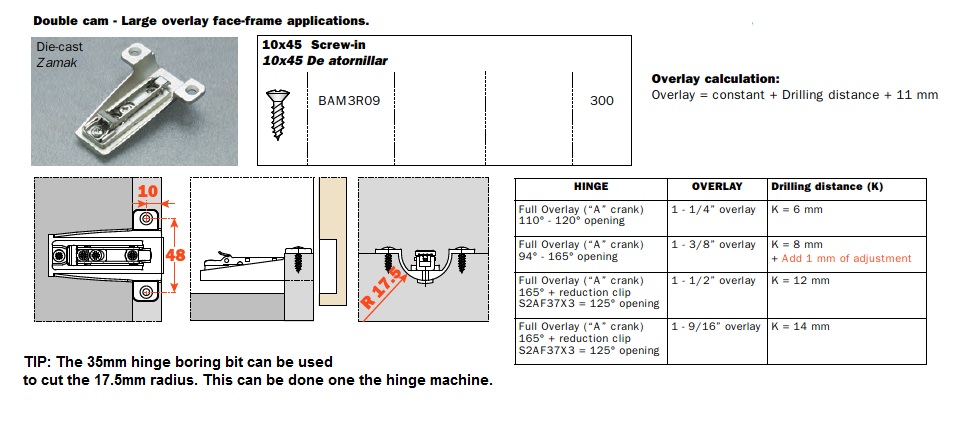

Just looking thru a 2008 catalog some more and noticed the Double Cam Large overlay face frame applications base plates part #BAM3R09 ... this still in production? Face frame needs bored out. Looks interesting! Up to 1 9/16" overlay.
Did i mention i need new catalogs..and some stickers, and pencils?
7/4/15       #10: Faceframe Hinges ...
Hey "Shop Door Guy",
You are correct about the F Series use for large overlays. You could get to a 33mm overlay here using the 1mm frame adapter plate. I say 1mm plate because there is no 0mm face frame adapter plate. He would also need to fill and re-bore for the hinges since the edge bore distance would need to be 15mm.
The BAM3R09 mounting plate is still in production and is commonly used for large overlays on a face frame. This would be another solution for TB but could be a real challenge to accomplish if the kitchen is already installed. It is best suited if planned for in advance and the frames are bored out prior to assembly.
This plate is particularly useful if you are using 1-1/4" overlay compact hinges throughout the job and you now need a 1-1/4" overlay for the 165 degree hinge on the lazy Susan cabinet. This is the primary the reason it was developed in the first place.
