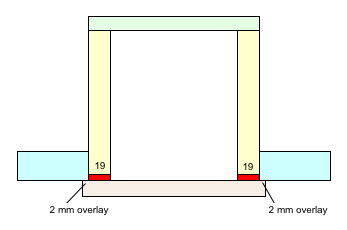

I generally use blum hinges but find myself needing something that will overlay the box farther than usual.
Does anybody know of a hinge that will overlay 2 mm past a piece of 19 mm plywood? I am looking for a total of about 21 mm though could go with 20mm if necessary. I would still like some ability to adjust the door laterally if possible so I don't to have to use all the adjustment at the getgo.
If possible I would like to be able to drill for these hinges with a Blum 3 hole press. Would be great if I could get a insertion adapter but can just tap the hinges in if need be.
Any ideas where to get this hinge?

Picture didn't take
this is what I am looking for

blum 73b3580.
Listed at the top of the page. It says up to 22mm overlay.
Down in the boring chart it only lists 20mm overlay. With a 0 plate. You might get this to work. It also is an inserta hinge. No insertion ram needed.

Here are the maximum overlay possibilities for Salice hinges when using a full overlay hinge and a 0mm mounting plate with the edge bore distance (K) shown.
94 degree hinge: 24mm overlay, K=9mm*
110 degree hinge: 21mm overlay, K=6mm*
120 degree hinge: 21mm overlay, K=6mm
165 degree hinge: 24mm overlay, K=9mm*
94 degree F Series: 34mm overlay, K=15mm
* Indicates a soft close option available.
