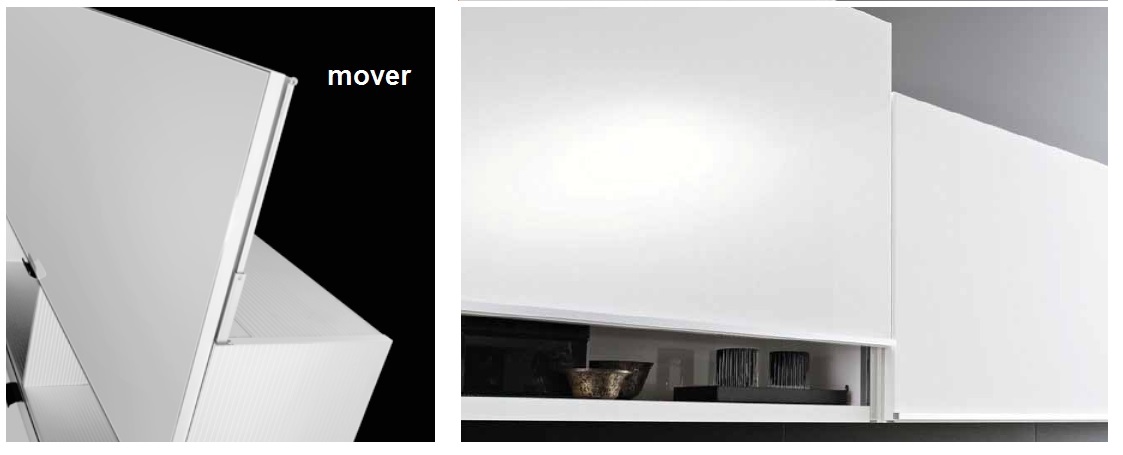

Hafele offers the EKU Libra sliding door hardware which would allow you to slide one door up and down with a counterweight dummy panel moving up and down in the back, or two bi parting doors moving up and down in the front. Hafele also sells the Salice " Mover" which allows one door to lift up in front of cabinet but door sizes are limited. Neither solution is terribly expensive.

This is the "Mover". This coplanar system is available for a door height of 600mm and for widths of 900mm, 1200mm, 1800mm and 2400mm as stock items.
