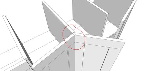

Is there a euro hinge that allows 2 door to swing on a single 3/4 divider?

8/1/15       #3: Is there a euro hing ...
Dan
No, but four euro hinges will do it.

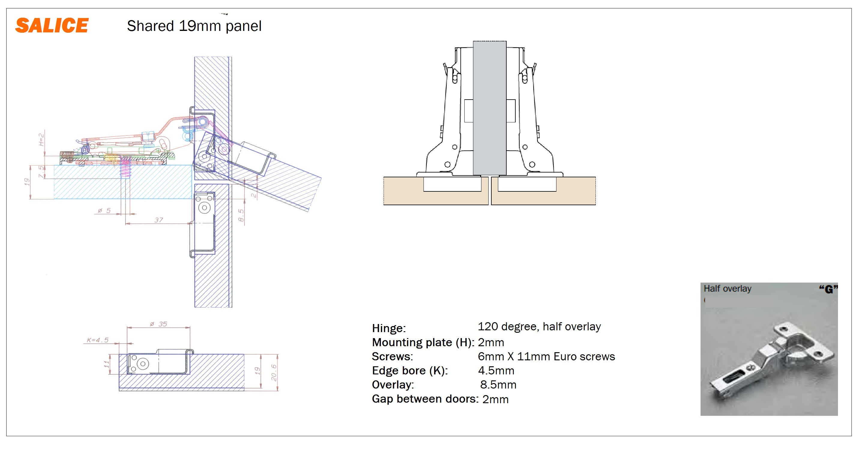

You can accomplish this with any major Euro hinge manufacturer. You either use a "half overlay" hinge, or a thicker base plate with a full overlay hinge. Typically the half overlay hinge will have an offset in the hinge arm compared to a straight arm on a full overlay hinge. You will need shorter screws to attach the base plate too.

8/1/15       #7: Is there a euro hing ...
Richard,
Here is the layout using Salice 120 degree, half overlay hinges and 2mm mounting plates. You could also use the tall mounting plate with a full overlay hinge as mentioned above.
The 11mm Euro screw actually extends into the panel 7.5mm. I have never seen issues with this length of screw. If this is a high use, commercial application, the sex bolts wouldn't be a bad idea either.
You could do the same application using a 94 degree, 110 degree or 165 degree hinges as well.
