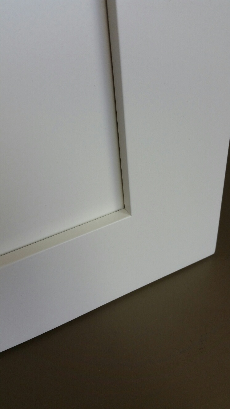

Derek S.
For what it's worth, we work with any medium. We're spraying Satin Impervo in the shop right now as a matter of fact, and last week sprayed some overpriced Farrow & Ball that a naïve homeowner got suckered into. But by and large, I believe that conversion varnish presents to the owner the best value as far as durability and cost is concerned. And as a part of that, I like to steer them away from caulking. The attached image is what I like to see.
