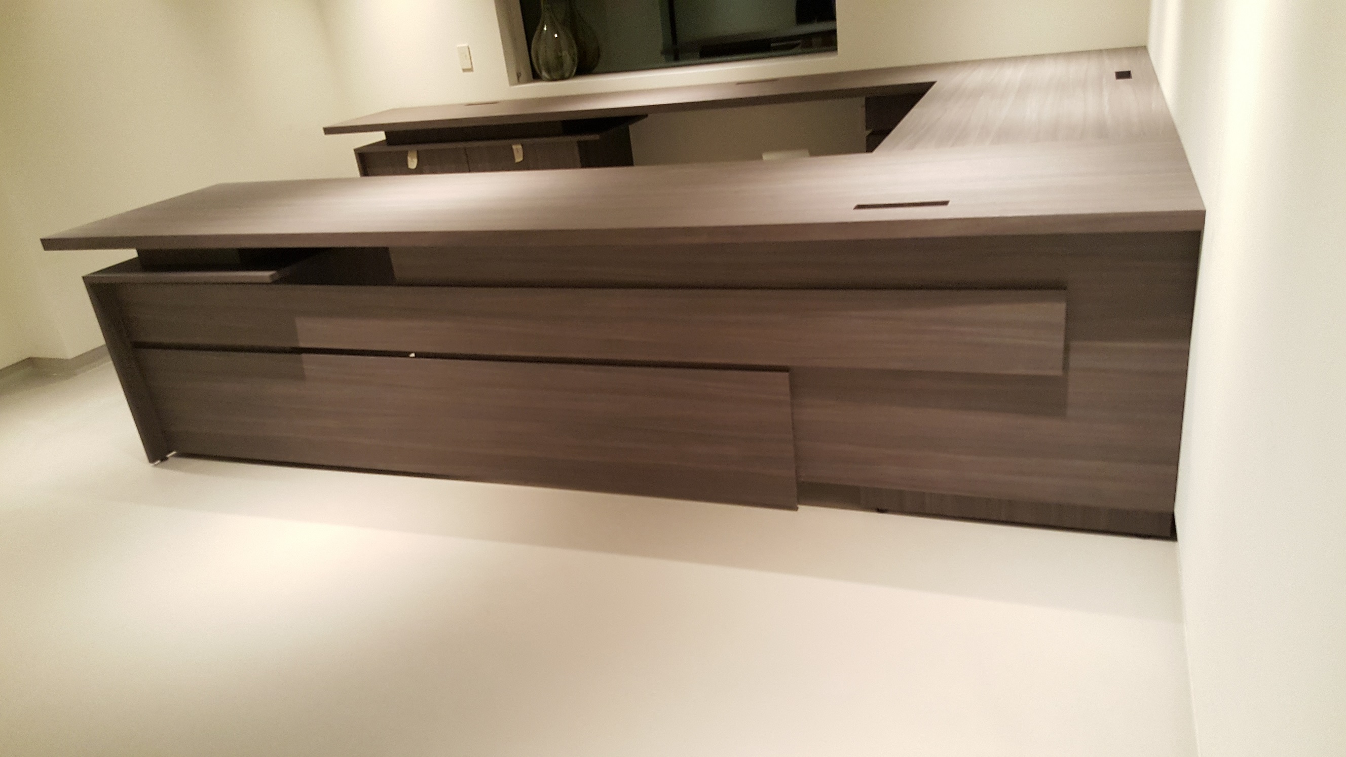

1/7/16       #11: Ideas on building desk ...
Shep Member
Hi guys just thought that I would send a update of a couple pics of the desk. I found a product called classic core here in phx az that is plywood sandwiched between mdf board.
The build was a pain in the but, but I did learn a lot and thanks for all of the tips and advice I appreciate it. Its not perfect but it came out pretty nice.
