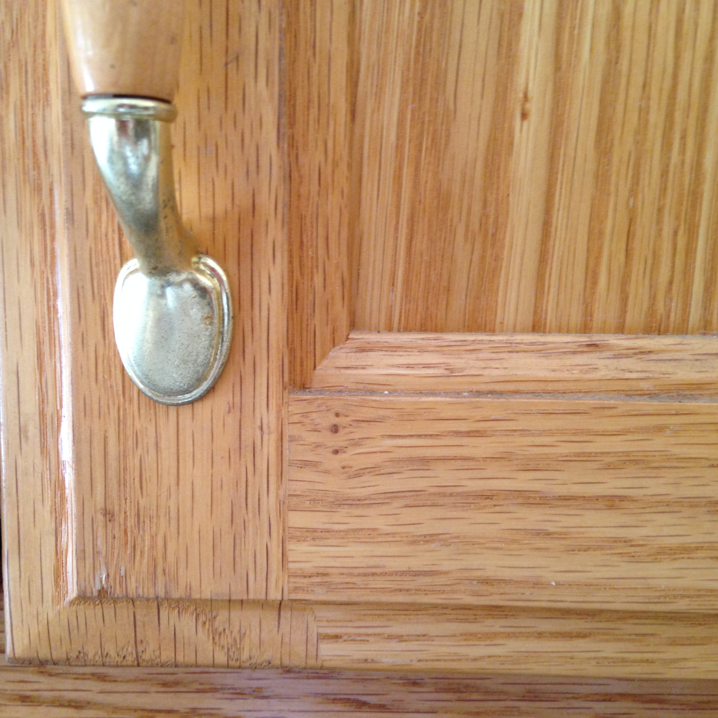

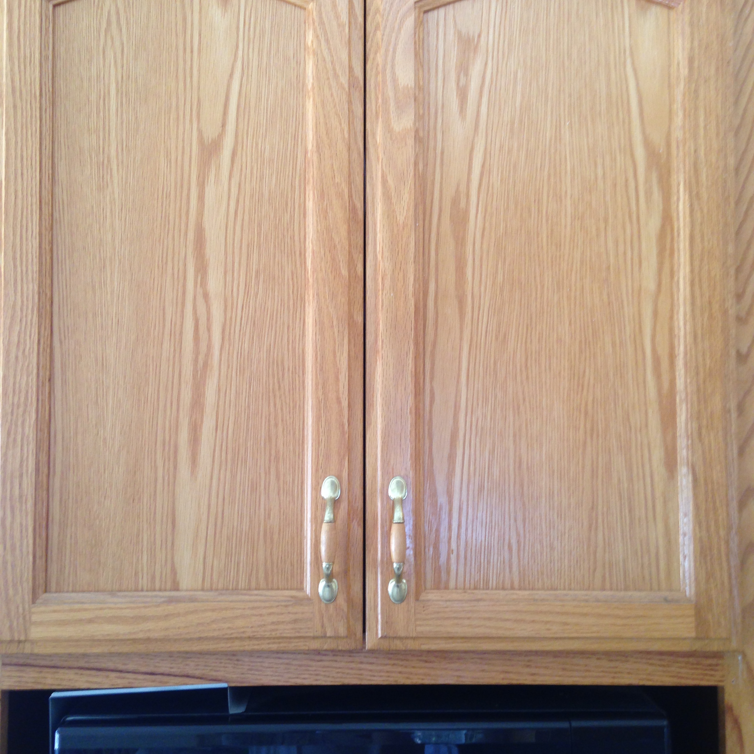

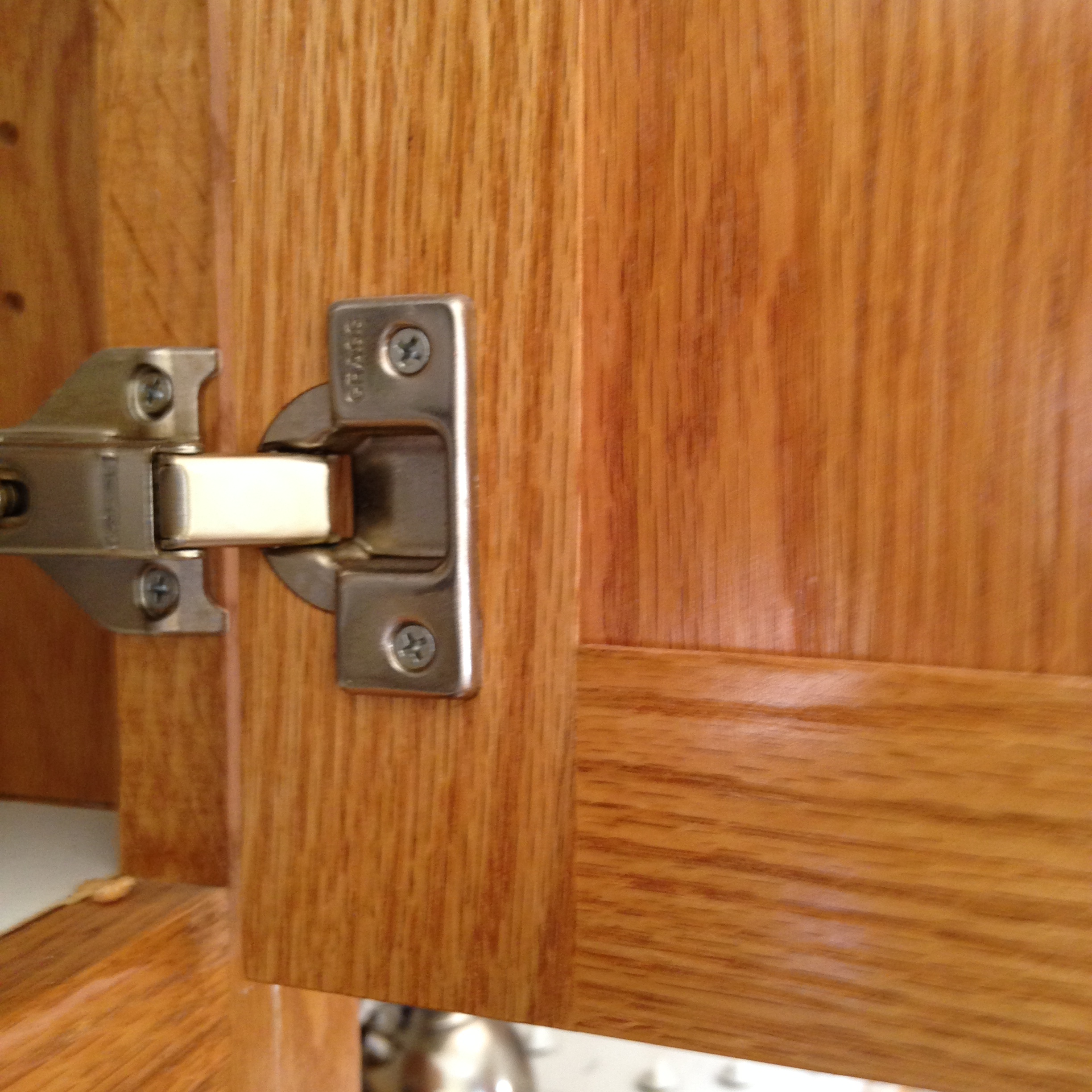

I purchased a new Thermadore 30" double wall oven to replace our worn out unit, but I didn't realize that Thermadore ovens don't fit conventional cabinet openings, this one requires 51 1/4" in height, width is fine. I'm wondering how difficult it would be to cut down the cabinet doors above the opening if I go ahead and adjust the opening size? Cabinets are not high end but I don't want to replace anything at this point.

Unless you have cutters to match that panel and outside edge profile, I'd say you'll have to have new doors.

Kelly Member
Thanks, was hoping that might not be the case but I don't know how I could possibly take rails and stiles off without damaging them.

John Member
You should be able to get the doors apart by drilling holes in the ends of the stiles and glueing in dowels that you can then push against with clamps turned around backwards. You may have to strip the door so that you can heat and/or steam the stile/rail joint to soften the glue, but it looks like they are just finished with clear finish so that's not such a bad proposition. You can try it with just heat first and perhaps you'll get lucky and they will come apart w/o harming the finish. I'd give it a shot. OK, put a clamp at both ends and put some force on them. Not so much that you risk breaking something but some noticeable force. Then take a heat gun and heat the stile/rail joint at both ends of one stile. Heat both sides of the joint. Keep heating, slowly, and at some point in say maybe 5 to 10 minutes the joints should start to open up if you have enough force on them. A little more force at that point and those joints should come apart. To get the other stile loose from the rails you can clamp the loose end of one rail in a wood vise so that you have something for that end of the clamp to push against. Repeat the heating process until that joint comes apart and the do the last joint the same way. Cut down the stiles and panels, trim off the dowels flush, and reassemble.

Kelly Member
Very Cool! Thank you John, I'm going to give it a whirl, gotta figure out the clamping situation but I think your idea will work

Andrew J. Coholic  Member
Website: http://www.joecoholiccustomfurniture.com
Ive cut down/modified a lot of doors. As long as you are cutting off more than the width of a rail, just cut the door to the length you need. Then slip out the panel (in my experience few if any manufacturers glue in 1/4" ply panels, but they are usually pinned - pull out the pins).
Then you can cut the bulk of the stile away from the loose rail, and use a sharp chisel or knife to clean away the remainder.
Cut the panel to correct length, scrape off the finish where the rail will sit and glue it back together. If you are careful when you clean up the ends of the rail, you can get it to fit near perfect.
9/25/15       #7: cabinet modification ...
If it turns out you need to break a glue joint: drill some vey small holes into the joint, get a syringe from a farm supply store and inject some vinegar. Many glues will soften enough to pull them apart.
