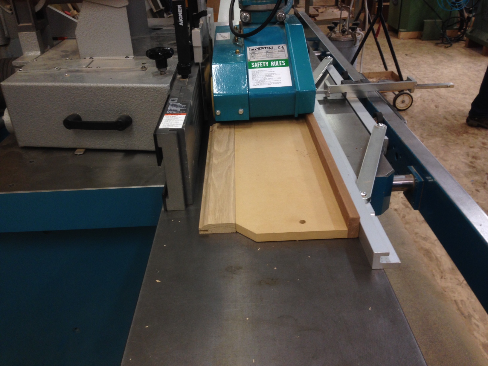

I just bought an Aigner Thickness Stop to use on my shaper for thicknessing face frame and door stock. I'd like to use the feeder with it. Problem is that the thickness stop is 0.76 inches thick so my feeder wheels would hit the fence on not contact the stock. Can anyone with the Aigner shed some light on how to make these cuts?
10/21/15       #2: Aigner Thickness Stop question ...
Joe Calhoon

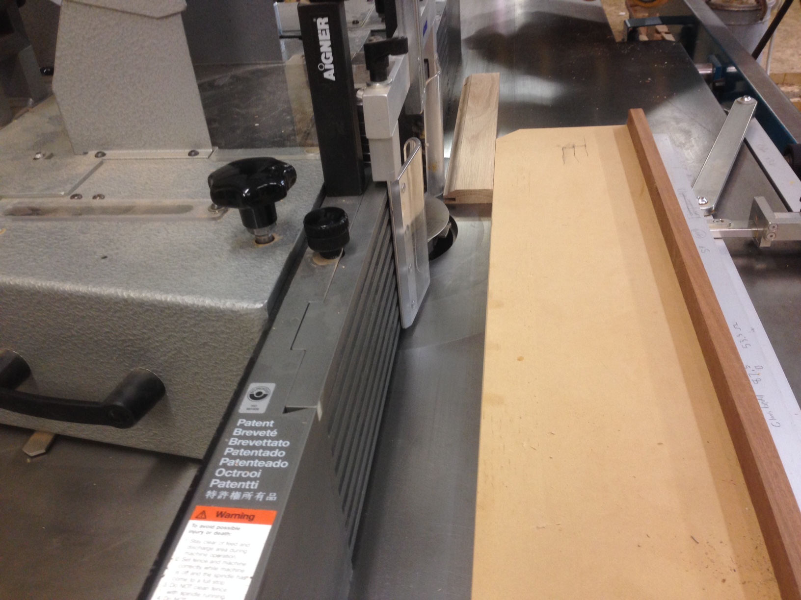

the thickness stop is designed around the German door and window trade and not ideal for running cabinet door size workpieces. The adjustable fence on top however is good for small mouldings and glass beads but a little too narrow for cabinet door stiles and rails.

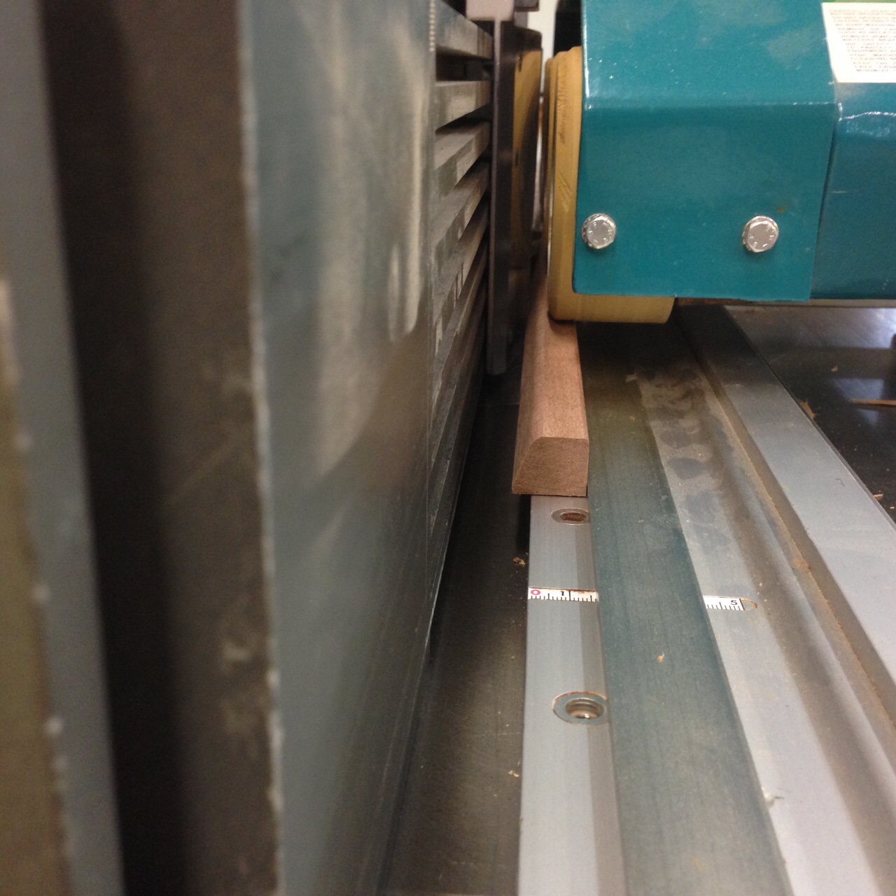

I made a add on fence that screws on where the normal fence goes that still allows use of the digital readout.
I plan to make a better setup with some metal angle that will attach to the fence so it does not need removal.
