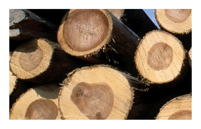

The attached picture shows growth rings from various trees. If you look at it you will see some trees are perfectly symmetrical and some trees a bit more oblong. What I am curious about is how this difference in shape takes place? Presumably one side of the tree is favored or disfavored by local ecology.
The picture shows a stark contrast between old parts of the tree and new parts. Some of the trees have a greater percentage of light colored wood. I am guessing that this is because the tree grew very fast. The tree on top has more old wood than new wood. I am guessing that this tree grew very slowly.

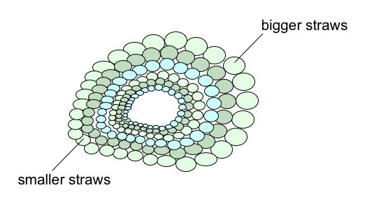

MY QUESTION is this: What causes the irregular shape to circumference? If we looked at each straw of the fiber, would the straws on the portion on the tree with fatter new growth be larger in diameter than the straws on the small side of the tree?
Does the diameter of each intrinsic straw contribute to the differential expansion or contraction of the tree? I.e., does a bigger diameter straw have more room to expand and contract?
Or is this completely off base and all straws are the same size but there are just more of them?

1) Am I correct in assuming that the growth rings are essentially composed of individual straws that, by capillary action, pull nutrients and moisture from the grown to top of straw?
2) Would a tree that manifests oblong shape (rather than perfectly circular) be an indication of more straws on one side of the tree or just fatter straws?

First, as you state, wood is made of cells that are hollow and are about 100 times longer than they are in diameter. The walls temcelves, when dealing with dry wood, absorb or desorb moisture in response to the relative humidity of the environment. When molecules enter the wall, they effectively spread the long cellulose molecules apart so they can fit in. So, with moisture addition, the cells expand. Likewise, when the molecules leave, the wall shrinks as the spots where the water had been. The reason for water going into a wal and to a particular location is because water is a bipolar molecule; that is, it has two hydrogens on one side of the molecule and an oxygen on the other. The molecule itself therefore has a _ and a + side. The cellulose molecules also have spots where there is a _ or + spot. (As an analogy, think of these spots as chemical magnets. So, the + on the water molecule is attracted tot he - on the cellulose.) This whole thing goes by the name of hydrogen bonding. In fact, water in the cell wall does not freeze or behave like liquid water as it is not a liquid, gas or solid.
Now as water is added or taken from the wall, the cells get fatter or skinnier, but do not change in length appreciable, unless the fibers in the cell wall are at an angle overall. More however, that if the cells are not vertical in the tree, then changes in width will show up as changes in length of lumber. This is why slope of grain can be a real big issue in a changing moisture environment.
To confuse the issue a bit more, when we look at the cells within a growth ring, we find some have thin walls and large openings and other have thick walls and small openings. Moisture absorption varies within the growth rings. This contrast is why that with a wood like pine is easy to count the growth rings. Further, some trees have special type of wood cells, such as tension wood in hardwoods, that are more absorptive of moisture than other cells. And some trees have the sapwood cells right near the bark with wide open cells, to conduct liquid from the roots to the leaves (it comes back down in the bark), but the rest of the wood is not active in conduction. In some cases, this low conduction wood also becomes a "garbage dump" for the tree and the chemicals deposited have odor, color, and plug the cells (example is white oak).
Oftentimes, we just talk about heartwood and sapwood. Heartwood are age-altered sapwood cells...all heartwood was a sapwood cell years before. However, within the sapwood we have inner sapwood and outer sapwood. it is the outer sapwood that participates mainly in conduction. This age change occurs at different rates at times, due in part to outside influences. Heartwood caused by such outside forces is called pathological heartwood...a good example is the heartwood around the location where a maple tree was tapped for its sap. The tree reacts to the outside force by encapsulating the area (it does not have antibodies) to prevent the affected area from spreading. This forms heartwood many years before it natural would happen.
Now, wood also shrinks and swells differently across the grain. When going ACROSS THE GRAIN AND parallel to the growth rings (tangential, T), the wood moves almost twice as much as compared to going across the rings (radial direction, R). The reason is that there are a few cells that run in and out, horizontally in the tree and these cells restrict the R movement. Some species with big rays (such as oak) have a greater difference than wood with small rays (such as eastern white pine). This difference between T and R is why we have cup toward the bark, a square becoming diamond shape, and a circle becoming oval as they dry.
Bottom line: At a microscopic level, not all cells are the same within a tree, so we see varied behavior.
Why do you see irregular shapes of the dark heartwood areas in your picture? This is because there are branches nearby that create heartwood as well and this joins with the stem's heartwood, and so at and near the junction area, looks irregular. In softwoods (needle trees) almost all irregular oval shape is caused by the formation of compression wood, which is caused by the tree reacting to an outside force. Note that there is no reason why each growth ring has the same number of cells on each side of an oval, contrary to your picture. However, with compression wood, the cell wall size changes and this changes cell size overall.
