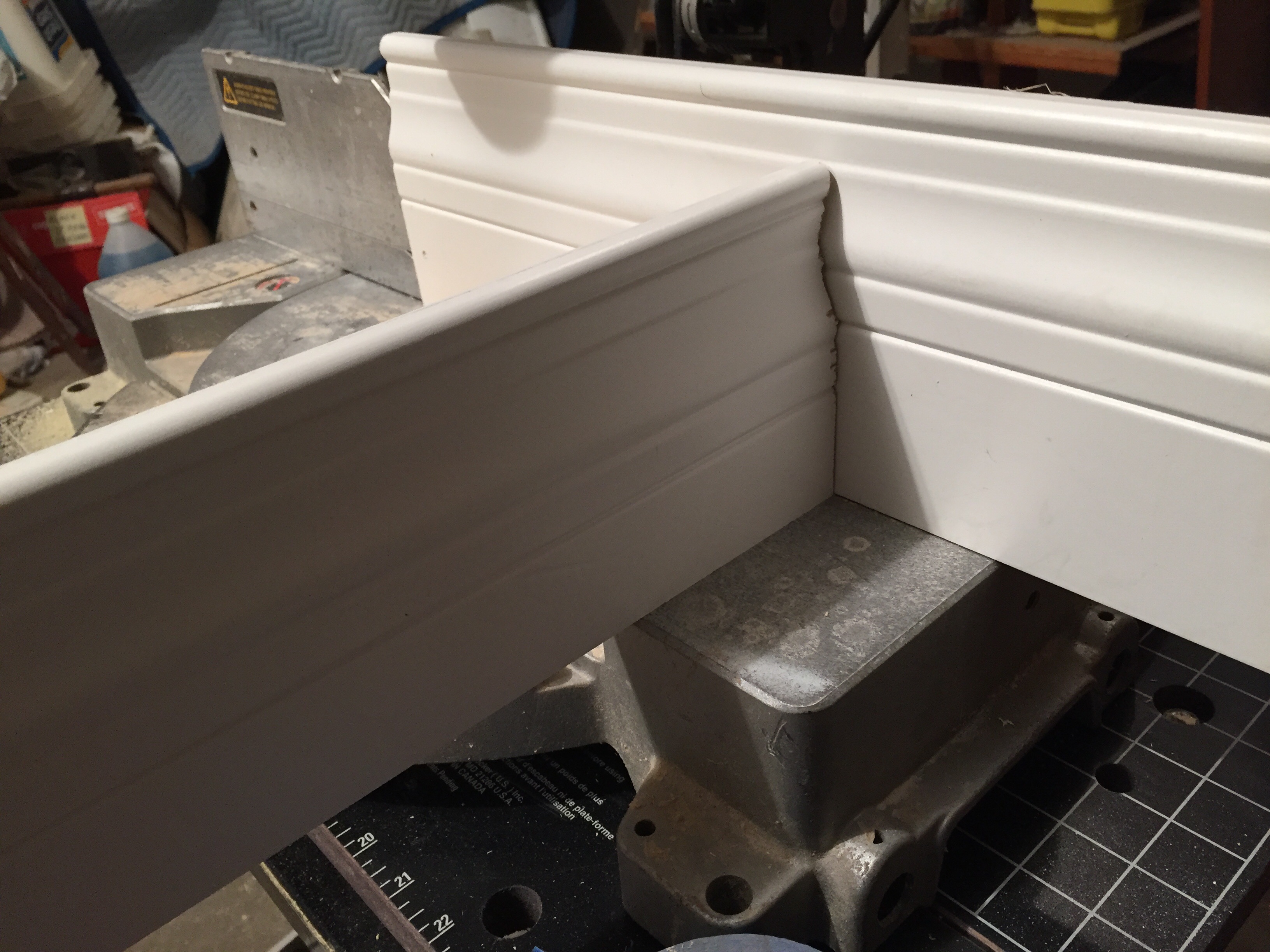

Im installing a closet system that has a lower height base than the existing and i need to cope one into the other and they have two different profiles at different heights. This one happens to be the same for both, but because of the toe kick height, the profiles dont line up OBVIOUSLY!!

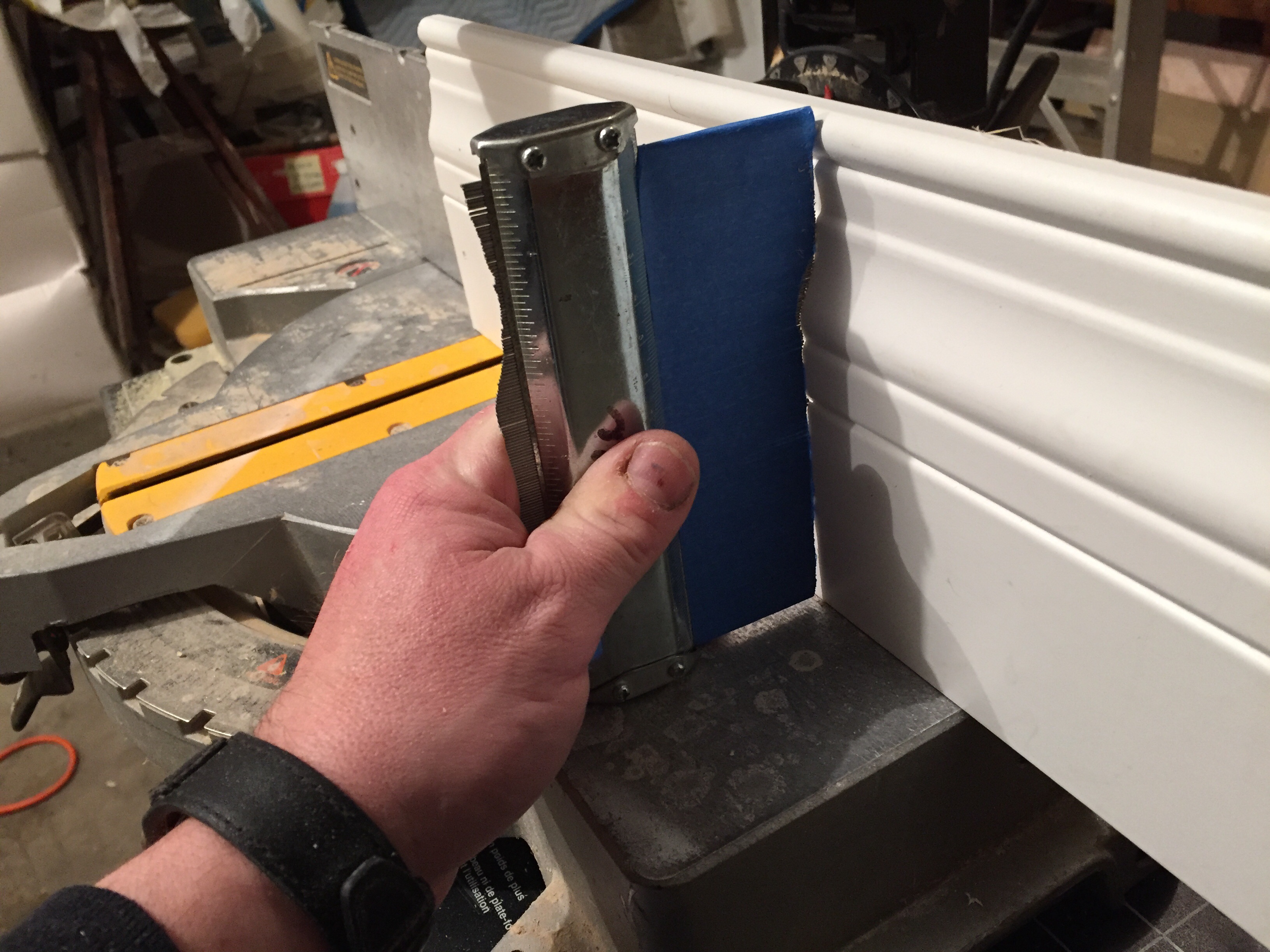

Other than using a compass or this tool below, someone had to have come up with a better tool than this

I usually just take a scrap piece of the existing base and use it as a pattern and mark the back of the one that I need to cut. Hope that makes sense.

Mike,
He's scribing one molding into another. Its not a simple cope. Its actually scribed into the other molding in the same way a cabinet is scribed into a lumpy wall.
Mike,
The compass or the finger gauge is really the only way to do that. No easy answers.
This is either a craftsman slow job or a carpenter fast job with a caulking gun.
I would use the finger gauge to mark a piece of 1/8" hardboard and fine tune it till it's decent. Then use that as a template to mark multiple backs of the molding to be cut. Stay away from the front.

Adam, what I'm talking about is basically the same as using the finger gauge method you describe only easier. I've done it many times.

What Mike said. Use a scrap piece of the taller base, place it on edge against the back of the shorter base, trace the profile and cut it with a jigsaw or coping saw. No different from the way I cope base when they match.
