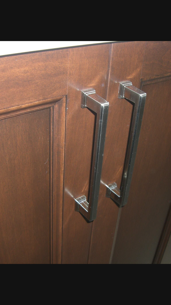

Which dore profile is this
12/3/15
ak
anyone know which profile this is? Thx
View higher quality, full size image (720 X 1280)
12/4/15       #2: Which dore profile is this ...
door shop guy
Is the profile 5/8" wide? If so, it is probably from a cabinet factory in mid/northern Kansas...cant remember the name.
BUT I had custom cutters made to match this profile because a customer wanted me to do the work. I am in south Kansas and can provide these doors for you. Contact me if i can help.
I want to say it was Mid Continent cabinetry but i cant be 100% sure.

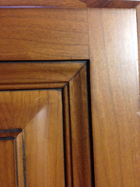

12/5/15       #3: Which dore profile is this ...
Mark V.
Conestoga's "Elite"
I use it all the time.
Mark
12/5/15       #4: Which dore profile is this ...
Aj
Found it but only on a mitered door?
12/5/15       #5: Which dore profile is this ...
John Langley
That look like you could do a frame and applied molding. The molding looks very much like a base cap
12/5/15       #6: Which dore profile is this ...
Mark V.
It's available in both mitered and cope & stick doors.
Here's a CRP-10 w/Elite bead
Mark
12/5/15       #7: Which dore profile is this ...
Mark V.
Also, if you want to make the doors yourself W. Moore Profiles has the "custom" brazed Freeborn cutters to do it. But, it is not quite as simple as a standard cope & stick setup, if you want to get good results.
Mark
