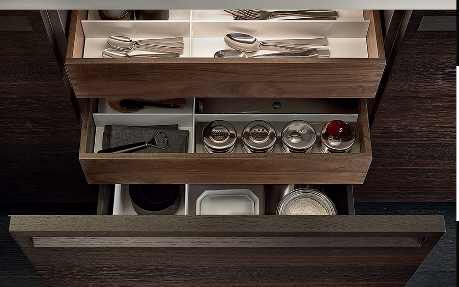

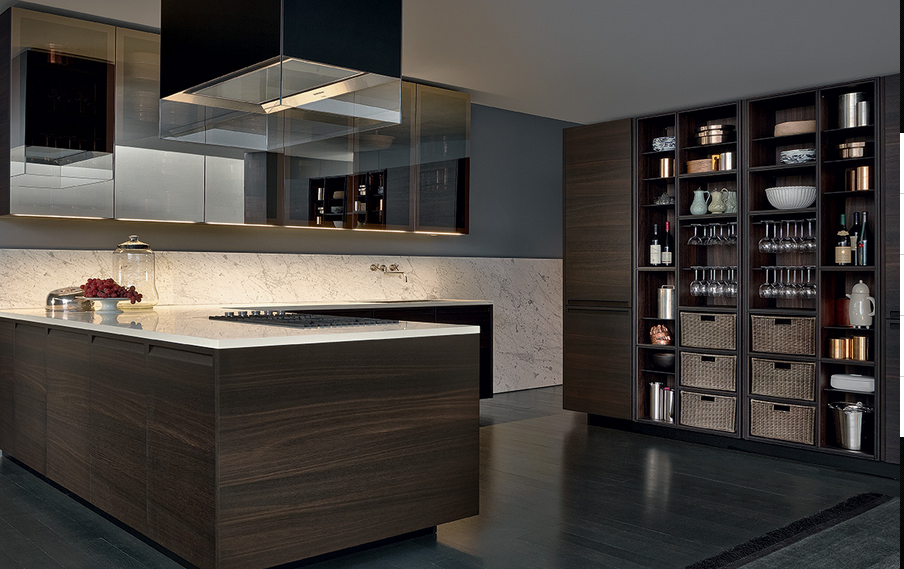

I have a client that wants us to make these type of routed handle on a new kitchen that we are bidding on.
We have done routed pull in the past, but not like in the attached picture.
has anyone done these before?

I've done things like this before, although never with the addition of pressing veneer on top of everything. I'm sure you see that you can't rout these handles with the doors intact, so it becomes a 4 piece door - 2 stiles, a large center section, and the handle. (You could also simply cut away the section for the handle, and then insert the handle, but unless you have a CNC, it might not be cost-effective) I would use Baltic birch or suitable, and the recessed handle part has to be solid wood matching the veneer pretty closely.
Plow your handle design in long pieces, and cut to fit. Then press your veneer. Finicky, especially trimming the veneer at those angles in corners of the the opening, but definitely doable if the price is right.
