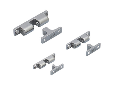

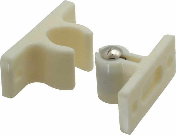

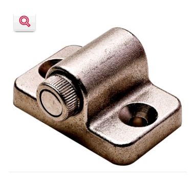

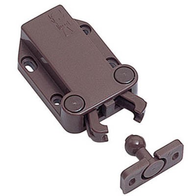

Chris
Any of these would keep a feisty door shut
