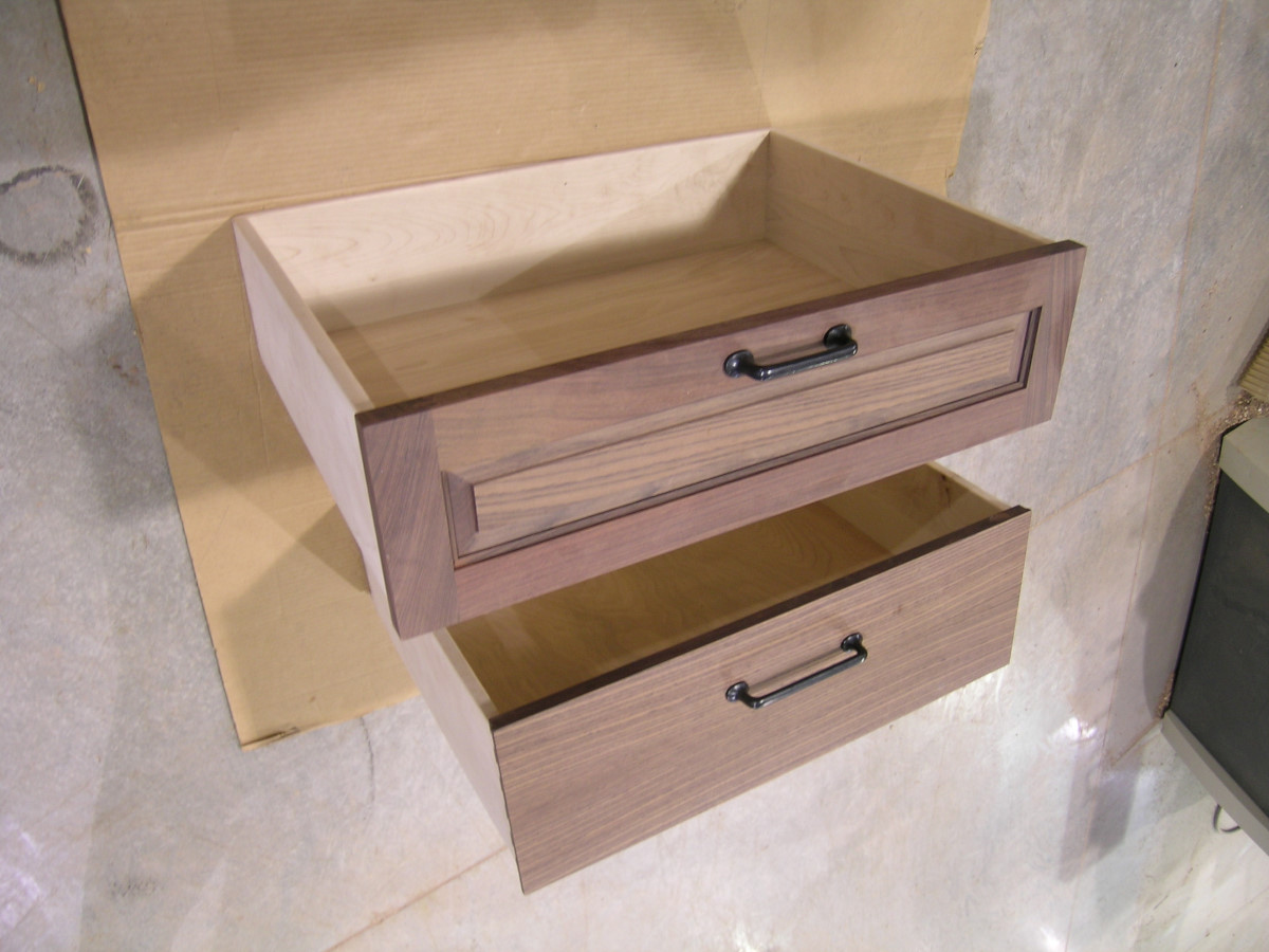

I apologize for being presumptive. Let me be more specific: I am talking about drawer fronts only. I know the clearances needed for the drawer box to cabinet dimensions - horizontally and vertically. I find them in the Blum Book pretty clearly shown.
With the furniture type design I have, the drawer fronts will overlay the drawer sides and cabinet case by about 7/8" on each side, so they come close to each other - 3 drawers wide, 4 drawers high. The photo attached is of a similar type drawer, but is a bit hard to see how the sides and top overhang the drawer box.
There is always some side to side "waggle" (technical term) in the slides. That is, they have some slop for forgiveness or whatever built in. Usually more horizontally than vertically. At least that is the way they used to be.
So, regardless of drawer box and cabinet interior sides, what should be the distance between the drawer edges? I'm sure Blum would say 1/4" or more, but we want much tighter clearances. I can mock it up if I have to, I just thought someone more familiar with the slides will know. I'd like a 1/8" clearance, but....?

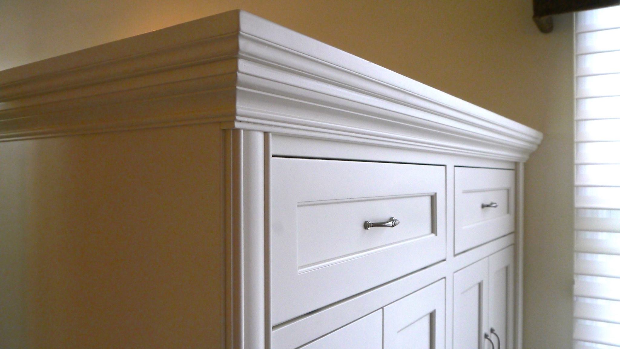

Same as Leo G, our gaps at 2 mm work out very nicely with no issues. The attached photo makes the gap appear larger, but that is due to the drawer face and frame edges being slightly broken (rounded over).
We've tried all the manufacturers, but always come back to the Blum. So, the last five years I've stayed with them.

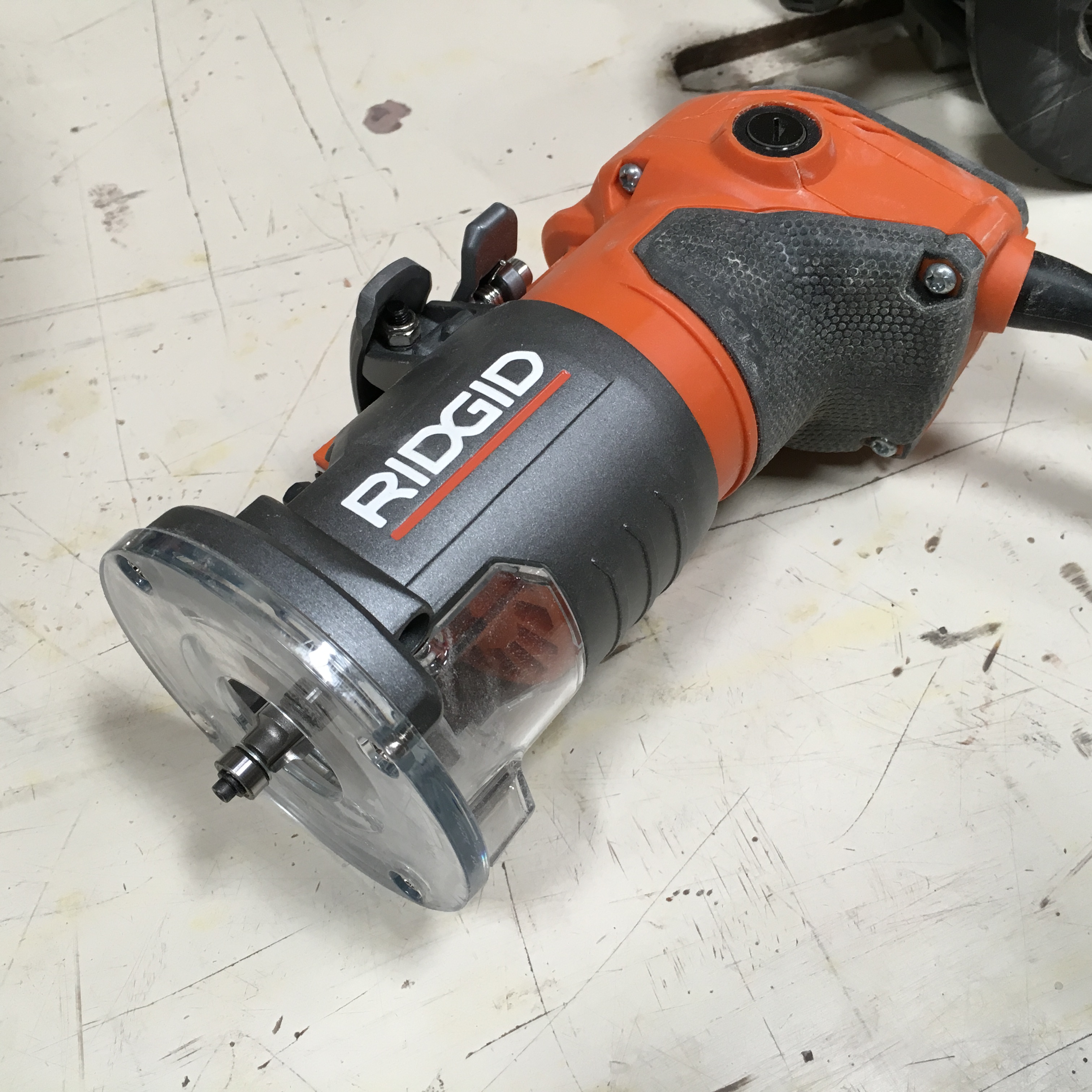

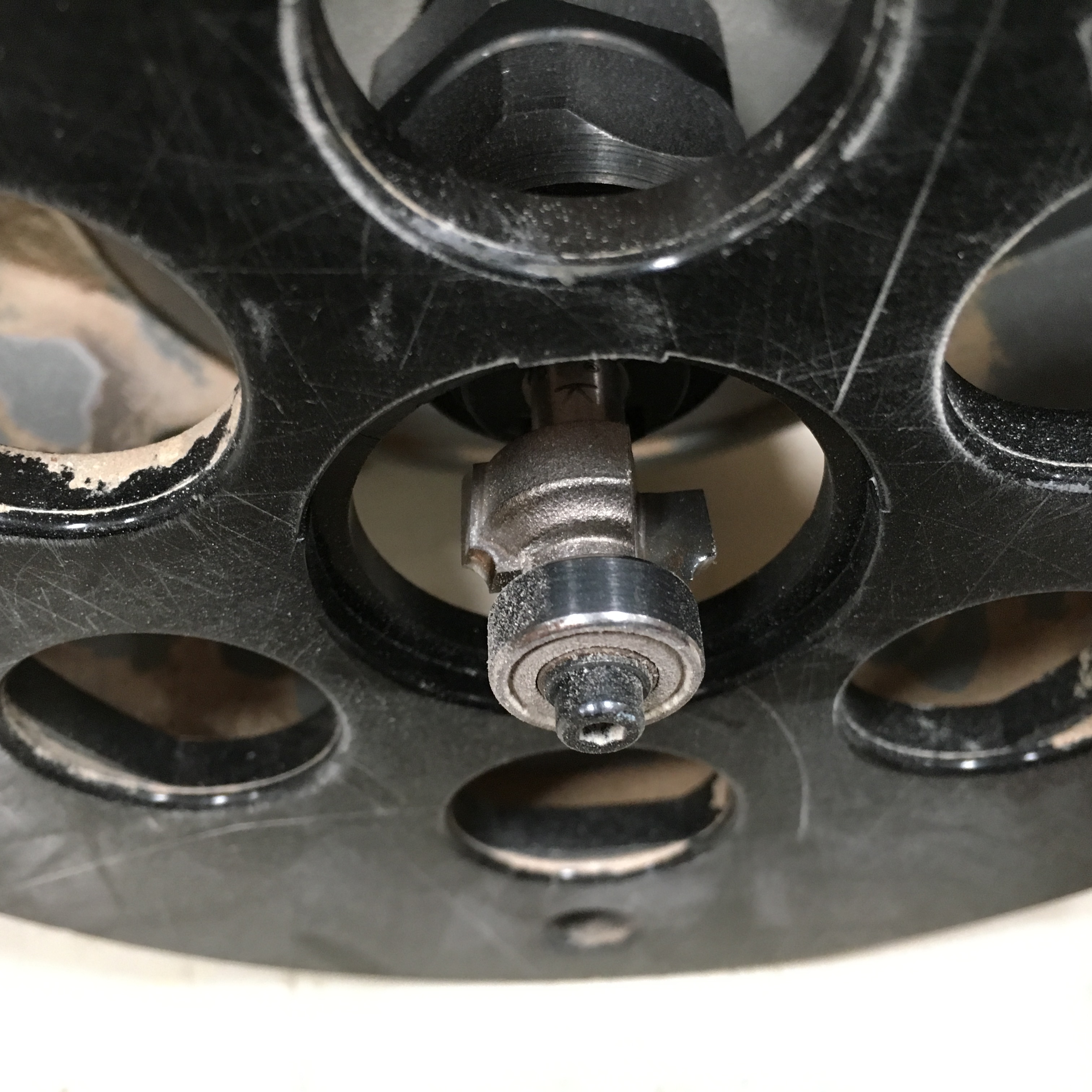

In response to questions I've received pertaining to the white cabinet I posted in this thread - the finish is Valspar Conversion Lacquer in Benjamin Moore "White Dove" over Valspar White Undercoat primers.
The edge details are made using carbide micro-rounding over bits (Amana brand) in hand held routers, followed by hand sanding with 220 grit paper to ensure no chatter marks which might show up on small break overs such as these drawerfaces and frame edges. I use 220 so as not to change the perfect radius made by the router bit - a coarser grit would do that if you are not very careful.
