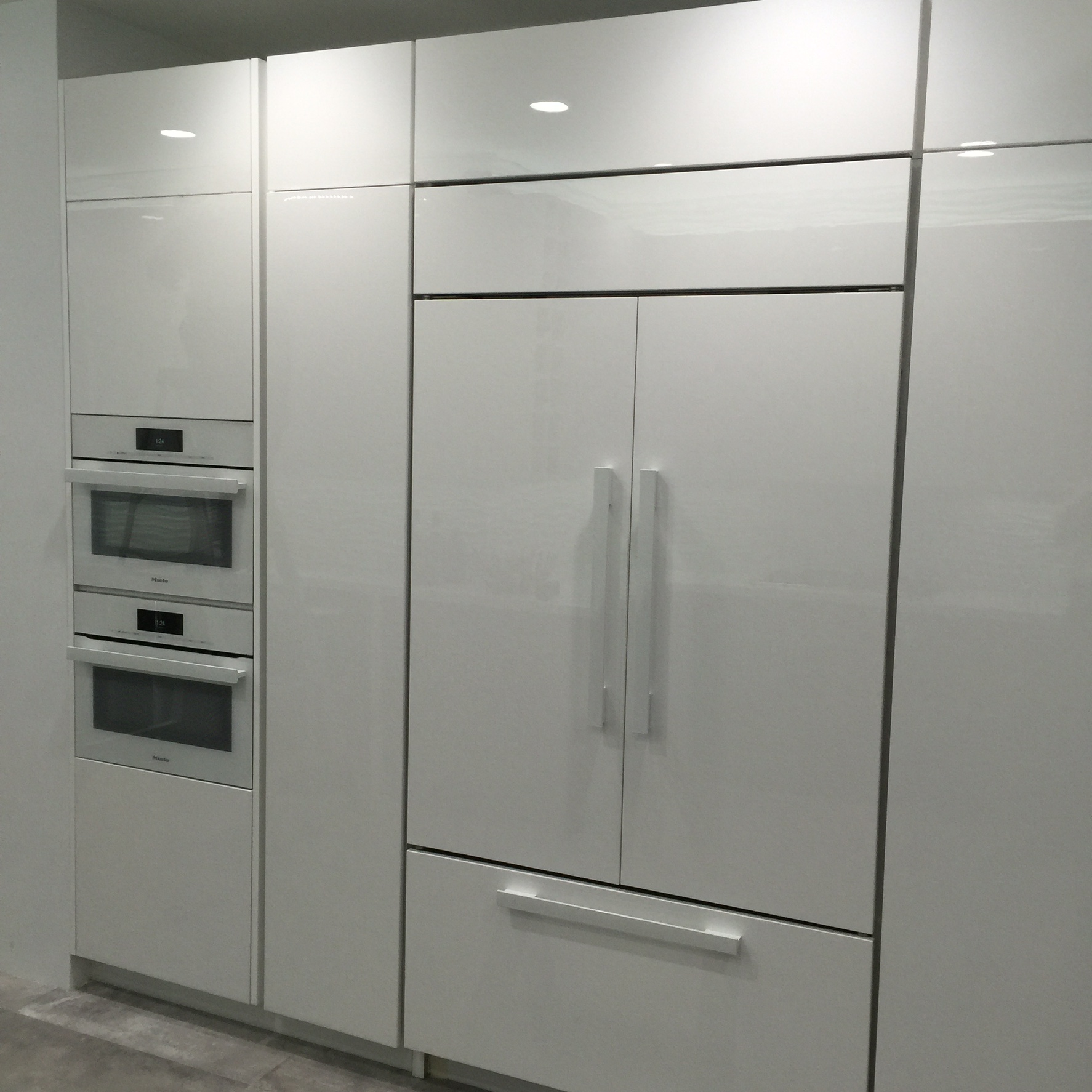

Not sure that was a good idea. Most clients who can afford these integrated appliances will have no problem with the extra panel install charge. This new challenge for you as a businessman could be looked at as a PITA, because it's not the way you like to do things.... Or an opportunity to wow a client and pick up higher paying projects from their friends who see the finished product. Add on a 100.00 per appliance plus the cost of the panel and use it to learn a process and make more money!

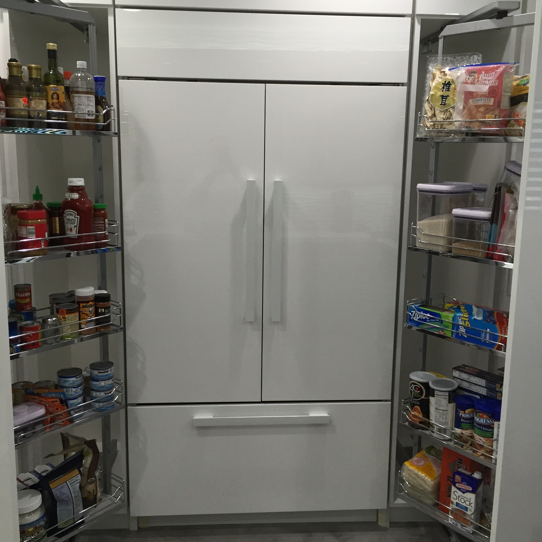

Besides the issue of integrated appliances, take a look at the 3rd picture of the Niger veneer kitchen. The horizontal grain on the fridge end panel took longer to apply then running the panel through the Bander in 15 seconds, but I have gotten higher paying jobs and a happy customer due to this extra detail. Not even a big deal to make...I just taped together some pieces of veneer with masking tape and ran it through the bander anyway... But these details catch the public's attention and bring more profitable work with it. After two integrated fridges, it is no longer a mystery.
