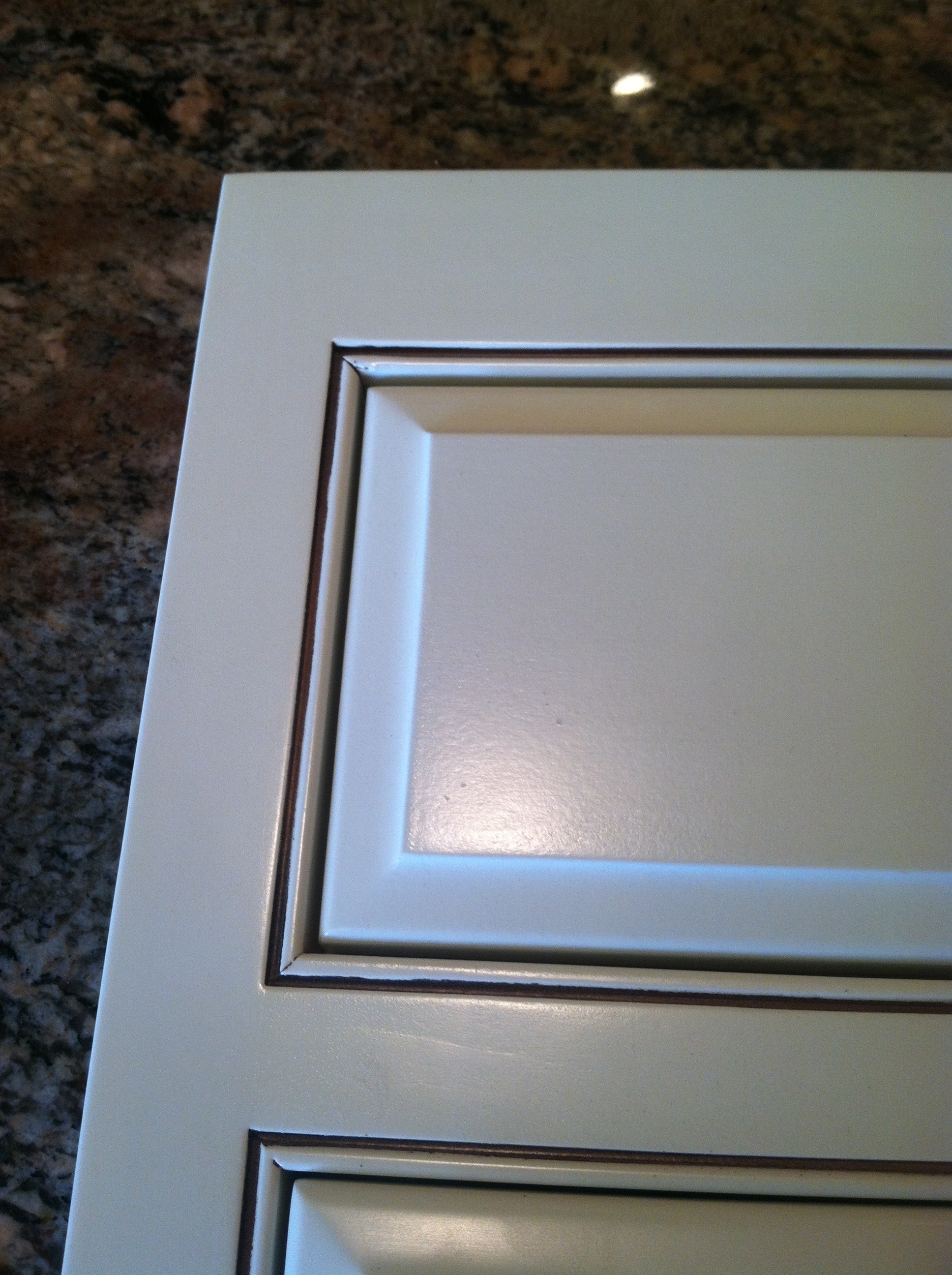

Duster
Has anyone seen this panel detail? I'm trying to find a cutter similar to this but I've had no luck yet. Any help would appreciated.
View higher quality, full size image (1936 X 2592)
1/13/16       #2: raised panel cutter ...
Call Freeborn Tool 1.800.523.8988

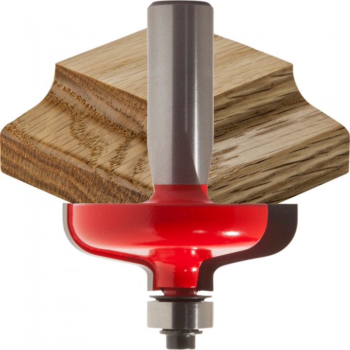

Jeff M
Is it not just a simple ogee door/drawer edge bit? That's what is looks like to me, with a very shallow cut.
View higher quality, full size image (720 X 720)
1/13/16       #4: raised panel cutter ...
Duster
It is similar to that door edge bit, but the profile needs to be an inch wide, plus the 7/16 long tongue I'll need to go into the panel.
1/13/16       #5: raised panel cutter ...
Duster
Sorry, I meant 7/16 of tongue to go into the stile...
