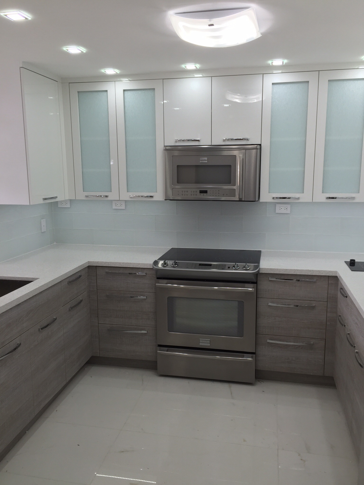

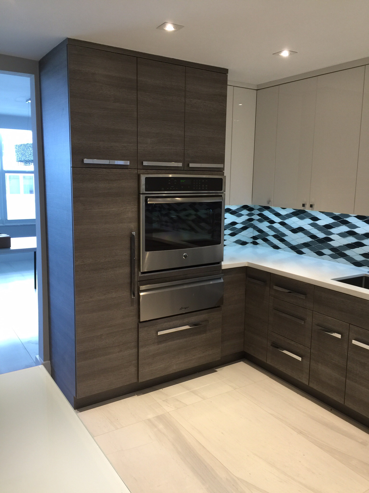

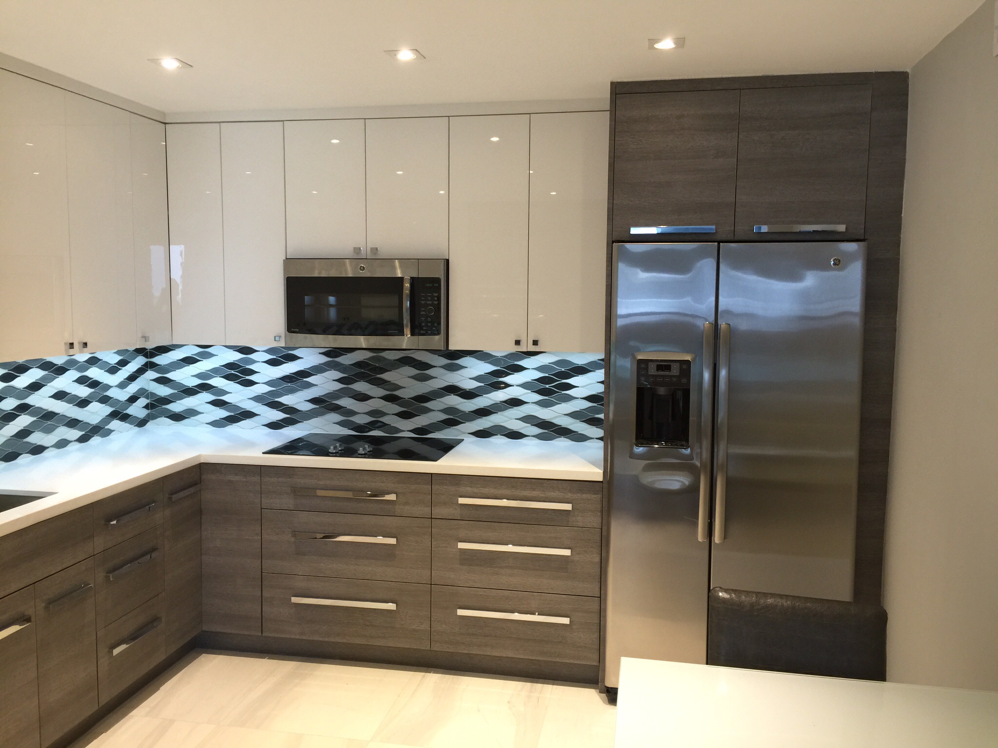

1/30/16       #4: Frameless Filler Option ...
Harold morantz
Some of the textured melamine shave a matching laminate. Some don't. You can cut your 1.5" strip if you are using a horizontal match from the same sheet as the doors next to it for a perfect match and then laminate the side f the panel. Since every sheet is identical, you can get a perfect match. Trying to make a miter in this material is possible, but you will get a very sharp edge that is easy to damage. We match our horizontal grains in this material all the time. If it's vertical, the grains are usually so varied that matching is very easy.
