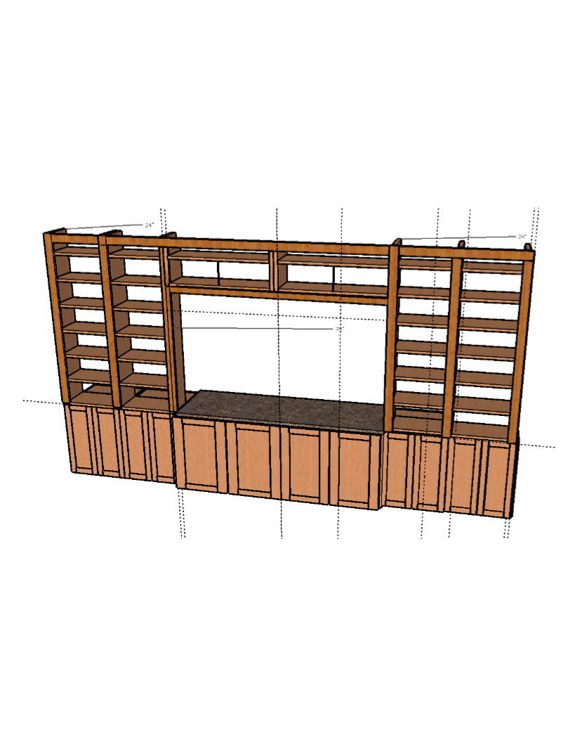

Thanks for the response. Here is the conceptual drawing I drafted for design approval. This unit fits into an alcove - One side is the outside wall and the other is a portion of the wall that juts out around mechanical stuff behind the wall.

Matt Calnen
I would either bump the center upper cabinet back or forward to make the install easier and play off the countertop cabinet bumpout. That's pretty standard of how I handle large casework, and make installation alot easier

Mike Member
I would make the whole thing in the shop. The bottom cabinets will be 3 units with a large scribe on the face frame were it meets the wall on the left and right. Put those 2 in first leaving the exact space needed for the center unit. The center unit looks like it is bumped out from the other side cabinets. Use a base grid, some guys on here call it a ladder system to rest the bottom units on. Then do something similar with a scribe for the top bookcases and hide the joint were the middle section is joined with molding. Bring it all together with crown and base board. That's how i would do it.
