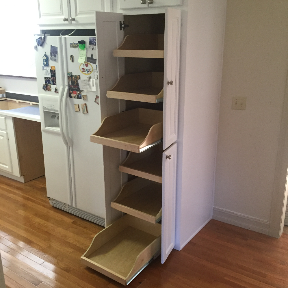

Richard Member
Can't take looking at that sideways cabinet any longer.
View higher quality, full size image (997 X 997)
2/7/16       #18: Base cabinet shelves question ...
Mike Fuson
I like drawers as well but I wouldn't want all drawers, it would just look odd to me.
Richard that pic is not sideways on my device???

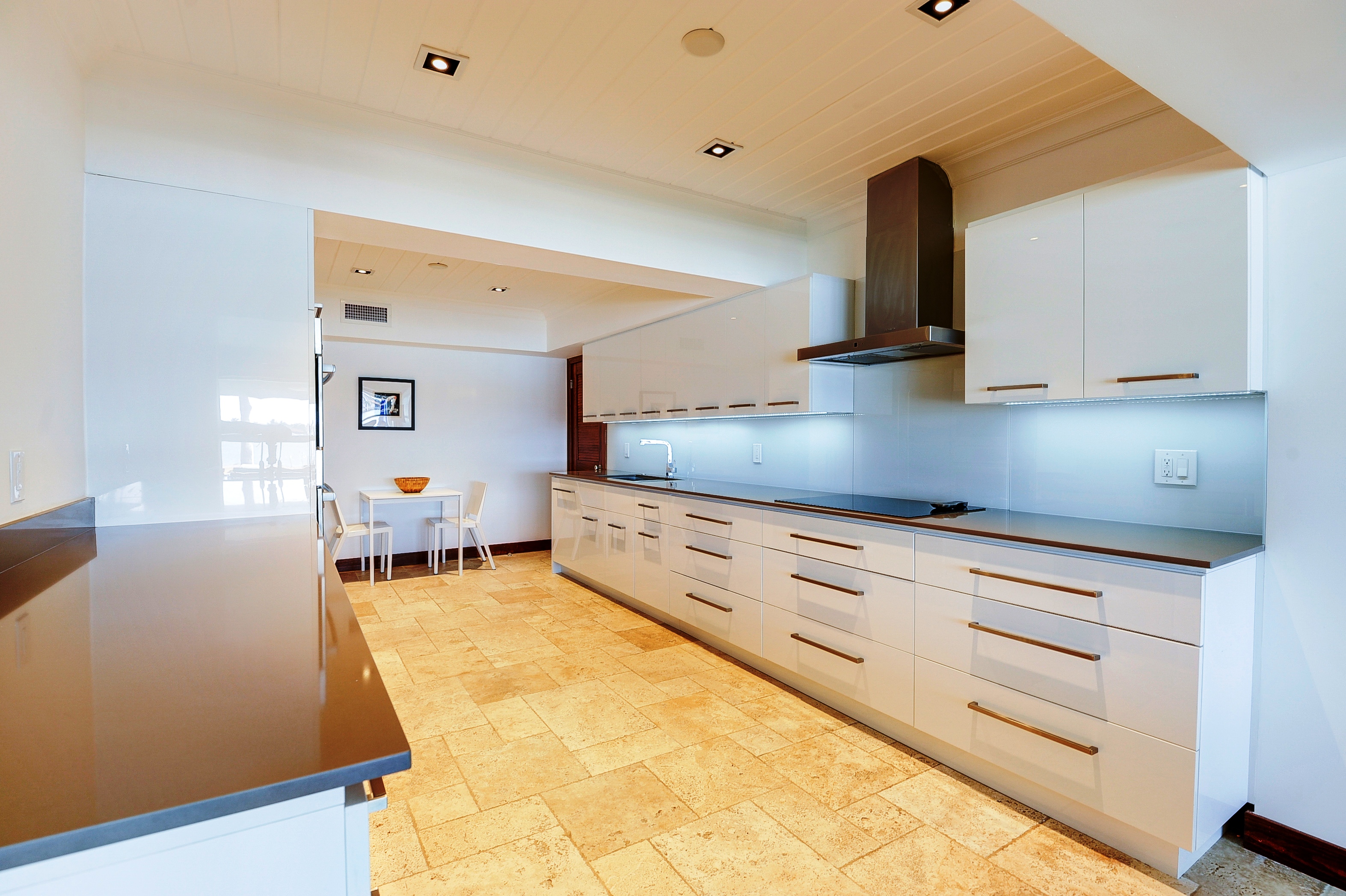

Harold morantz
Drawers all the way, except pantries. We use zero clearance Blum 165 degree hinges that do not require any spacers. Drawer slides mount in system holes with euroscrews. Harold.
View higher quality, full size image (3146 X 2095)
2/9/16       #20: Base cabinet shelves question ...
Beautiful white kitchen. Really don't like 165 hinges, they start sagging way sooner than the regular 120's.
