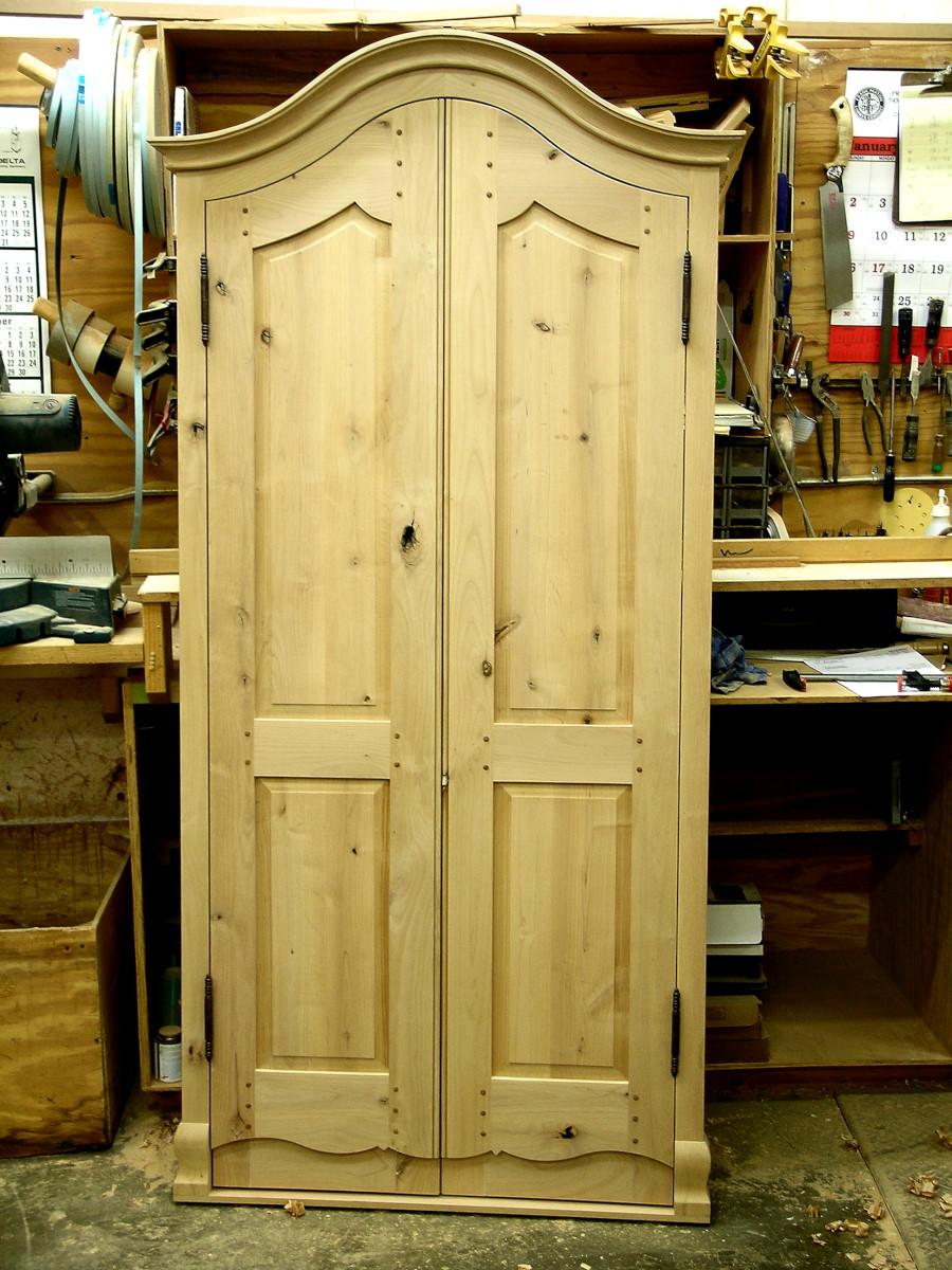

Duster
I did these walk in pantry doors with 5 Blum thick door hinges per door. It worked well and I haven't had any call backs. I'm sure there are other ways to do it, but it was a pretty simple solution.
View higher quality, full size image (600 X 800)

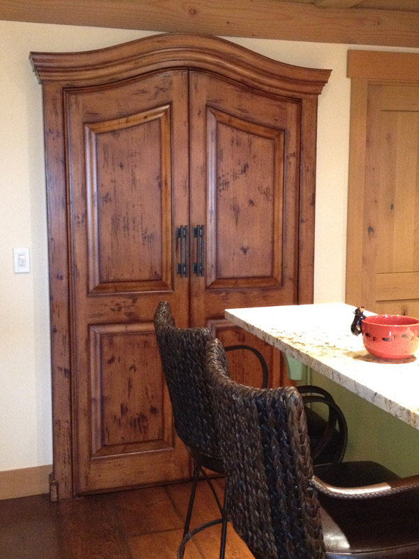

2/9/16       #4: walk through pantry hinges ...
Walk thru doors are most commonly called passage doors and use butt hinges, and are a minimum 1-3/8" thick. "Cabinet" doors can be made larger and called passage doors, but they are a bit out of their league, so I would advise a change in hinges and frame type.
Duster, I think we are both eating the same French bread. Or we at least think alike.
The doors in the the photo have tall Picarde type hinges to carry that Continental look.
View higher quality, full size image (900 X 1200)
