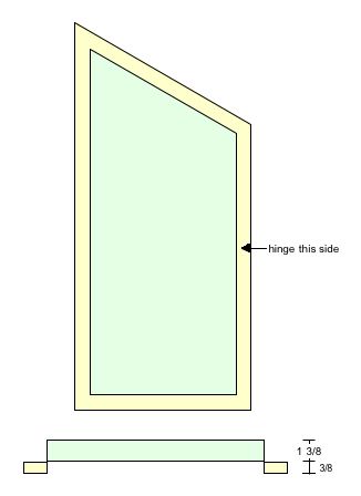

We are trying to produce a hidden door within wainscot paneling. The staves for the paneling are 3/8 thick. The door is 1 3/8 thick solid core. Everything has a square edge shaker profile with slight ease.
Can this be done with a european style concealed hinge?

Dennis, take a closer look at the plan detail. He's showing a 1 3/8" thick door recessed completely in the frame. I'm not so sure the F series will throw the door out of the way of the frame will it?
I'm also not so sure that the angled part will clear.

Is this a door into another room or a cabinet? Swinging into or out of the room?
If it swings out of the room we leave the "staves" on the wall and swing the door (panel) only. The door swings into the "staves" as a stop. This can be accomplished with a standard jamb ripped the same thickness as the door with standard hinges. Just install it flush to the back plane of your wainscoting. For situations with poor jamb structure you can always go with a Rixon pivot hinge.
If this is swinging into the room, a Euro may be the best option. Wondering if the door could be mortised/notched to reduce the thickness where the cup mounts and buy some extra opening clearance/throw?
