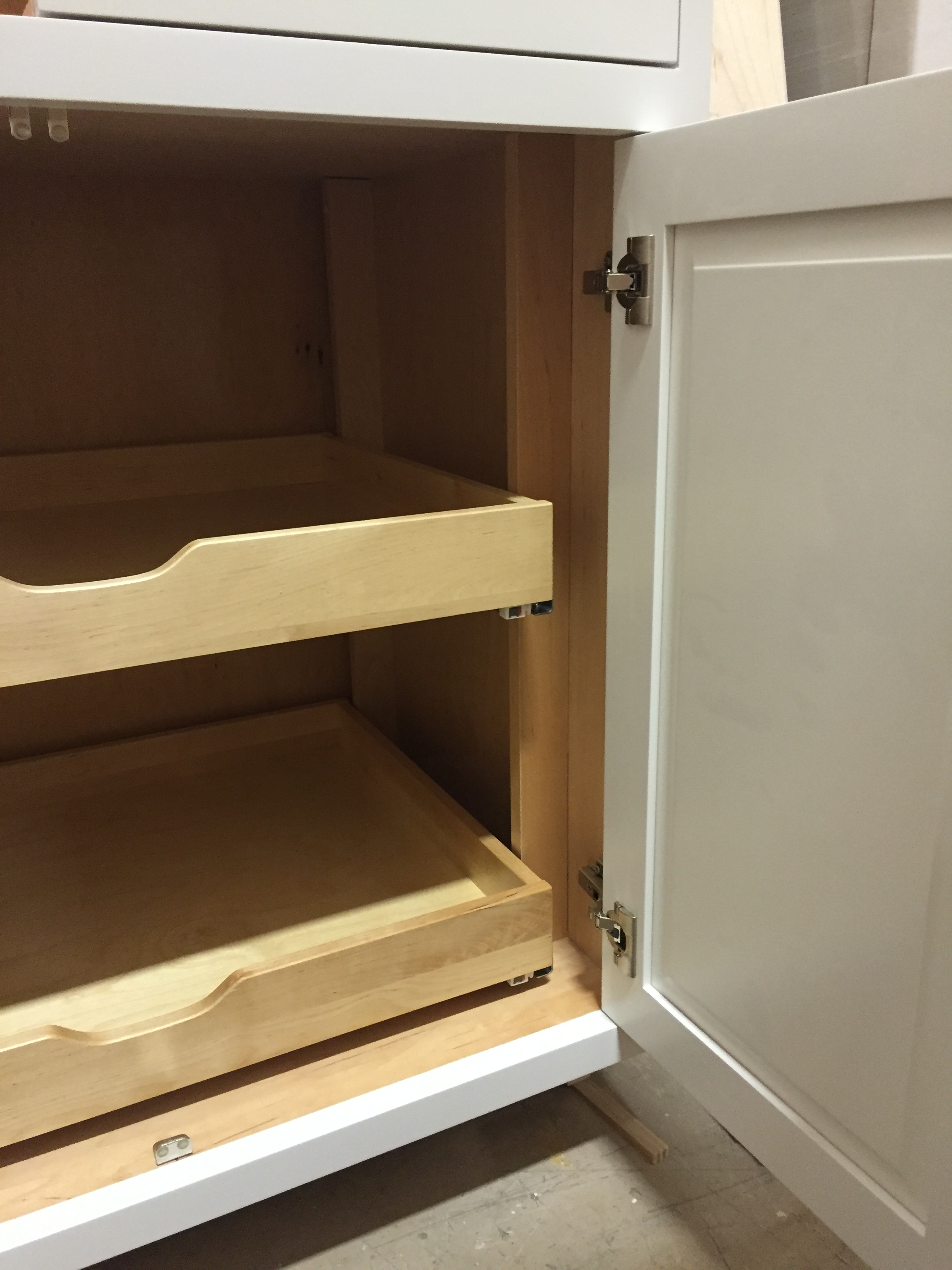

Here's how we set the side boxes:

Edi, we also build a lot of inset cabs. We do our tray blocking the same way as in your pic. We only use the tenn-tex system for pantries due to the ease of adjustment for the customer.
Personally, the clear coated wood looks better then the tenn-tex and honestly easier to install. Buy the time you run all the screws needed to secure the 2" plastic pilasters and install the little hooks on your slides...well lets just say the wood route is the ticket for base cab trays. We made a simple template out of a sheet of 1/4 mdf that we lay over the ends prior to assembly and drill all the holes. I keep a back stock of pre-finished rips for all my different stand off thicknesses.
