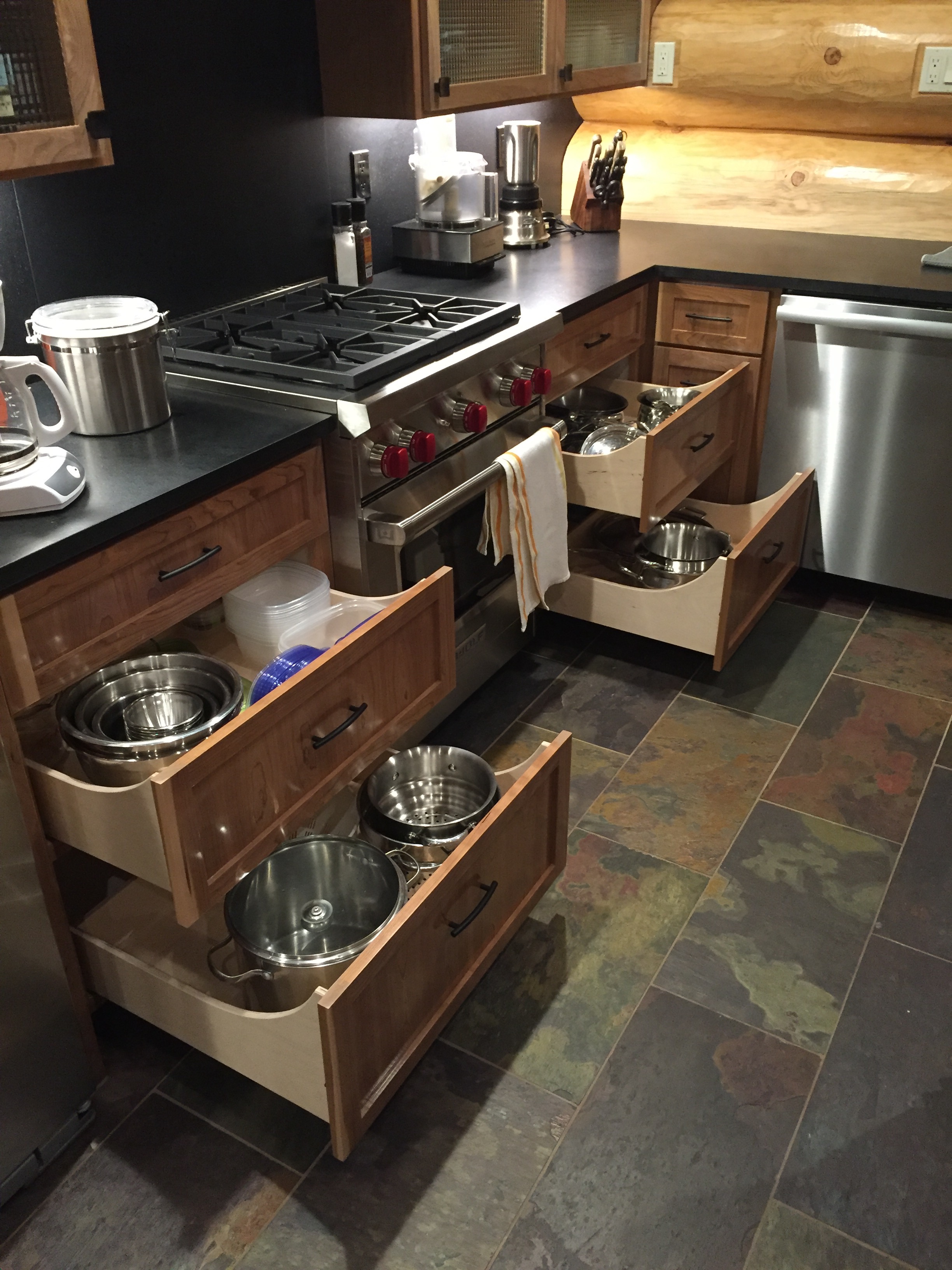

Hello folks.
I'm a general contractor who also does a limited amount of cabinetmaking. I've been experimenting with an idea and wanted to throw it out there and draw on the experience of you guys.
Rollouts seem to me that they came about as a retrofit for existing cabinets?
When designing new kitchens rollouts seemed kind of odd. I always wondered why not just build drawers? Drawers are simpler to function, simply pull as opposed to open doors then pull. Drawers will net more width as most rollout boxes have to be narrowed to fit between the hinges.
The only real downside that I could think of with drawers is the depth of the box could make it a little harder to grab handles for pots/ pans.

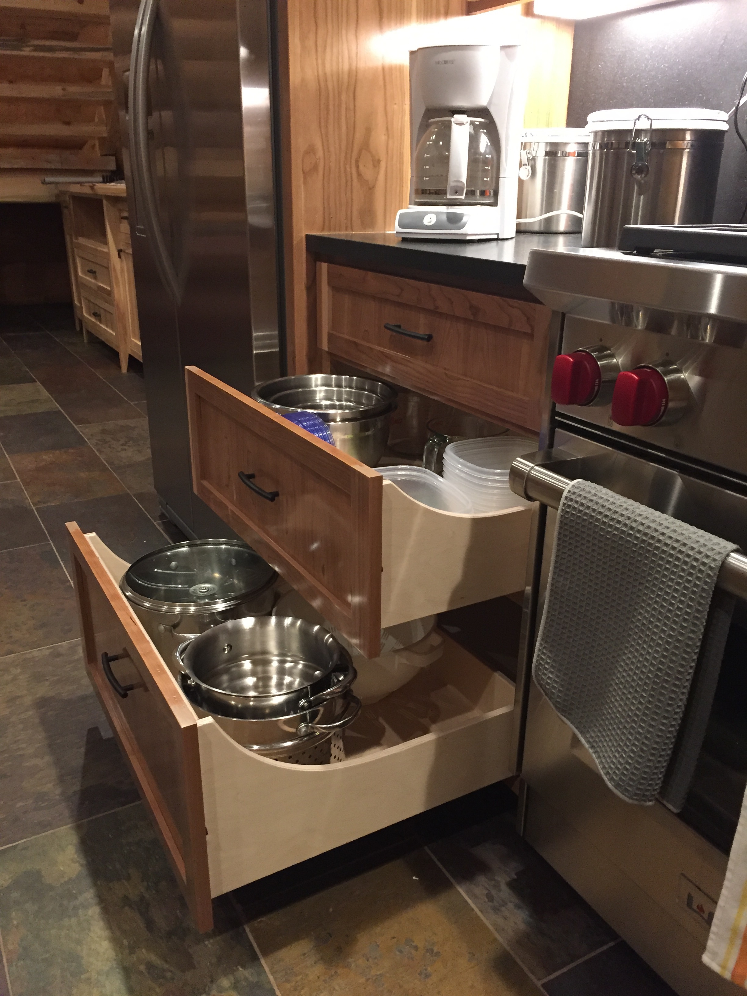

I've been building these drawer boxes to the sides of a range for pot and pan storage. I swoop the sides down so handles are easy to grab. I use 1/2" ply bottoms and the heavy duty slides. I used them in a remodel a few years ago then recently in a place I built for myself. So far I've enjoyed them, and I like to cook.
Comments, ideas and suggestions welcomed!

I think the swoops are not necessary. You could have as easily made the "swoop" as shallow as your sides and arrived at the same usability. I guess the "swoop" looks cool to some people. Pull outs don't make sense in a new kitchen for reasons you have described.

The scooped sides of your drawers look great. Besides being highly functional, the design really adds a nice custom feel to the kitchen.

Like the swoops... different... 8^)

I like the swoop. It looks solid. A big front on a small box always looks odd and usually feels less solid. Its a great differentiator, not to many will put time and effort into it and it gives your product a custom look.
