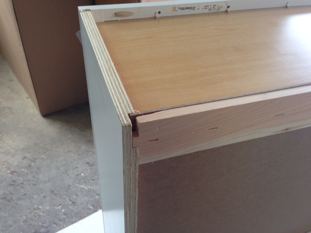

Is there anything wrong with this cabinet
3/30/16
shawn Member
Hi I am new to forum and am seeking advice from someone more knowlegeable than myself concerning cabinets. Is this an acceptable cabinet or not. Local km rep has talked to someone at factory and says there is no problem with this cabinet a W3636. They say glue holds cab together and not the open mortise and tenon joint of top rail. Thx for you help
3/30/16       #2: Is there anything wrong with this c ...
DS
Looks like every other pre-fab cabinet I have seen. I'd be just as concerned with the lack of flushness between the endpanel and the faceframe. Imagine trying to lay down a flat crown or flat valence to the top or bottom of that cabinet.
3/30/16       #3: Is there anything wrong with this c ...
shawn Member
Thx for the info
3/31/16       #4: Is there anything wrong with this c ...
Chris
Nothing out of the ordinary. A C- is what I would grade this cabinetry. Unfortunately, this is the norm for non custom big box store cabinetry. Why it is this way is another question.
4/3/16       #5: Is there anything wrong with this c ...
jake
Just don't load it full of books or reams of copy paper.
4/3/16       #6: Is there anything wrong with this c ...
KAP
Is there anything wrong? If it was on the front yes, but if you use glue an staples and 1/4" backs in cabinets, that little section is not going to affects it performance one way or another as both glue and staples are right at that section...
IMHO, they spent more time making that nasty piece than was necessary...
