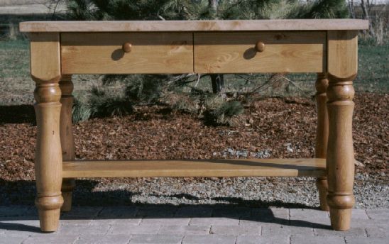

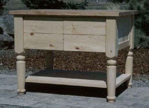

We usually dado a slot into the legs to accept the shelf. The shelf is secured to the legs with a couple pocket screws on the underside. I've done dozens of these, and this method has worked well for us.
