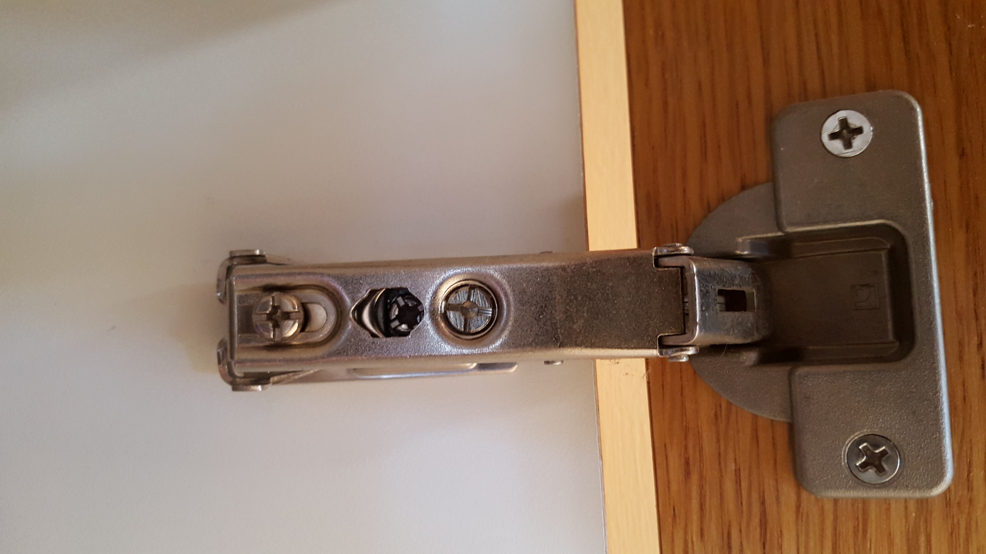

I'm replacing doors on a older Woodmode kitchen that was put in in the late 80's (at least that's what the homeowner was told when they purchased the house). I use mainly Blum hinges, but don't recognize these hinges. They have a quick release which is like a pair of wings at rear of hinge. I can't find a name on them although marked made in Austria. Anyone know what they are and if still available. The homeowner wants to reuse if possible, but there are a few that need replacement.
I do know the screw holes are not quite the sam as Blum's. Maybe Mepla?
Thanks for any info.

Can you post a pic.

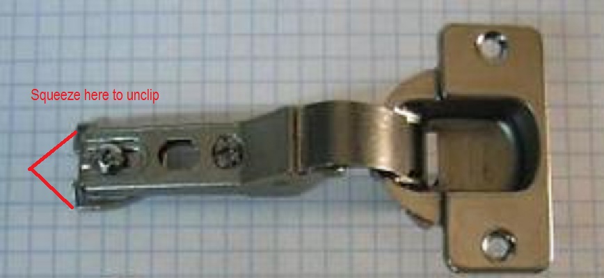

Sorry, I just noticed you mentioned the wings on the back to unclip the hinge. This is probably the old Mepla "DS Clip" hinge.

Since you're making new doors, I would just use whatever hinges match the overlay you need.

Sorry guys, I forgot to post the photo! Dennis, you're right as usual. Looks like it is a Mepla. I mentioned just replacing all the hinges but she wants to keep these for some reason. I'll see if Grass has something that will work.

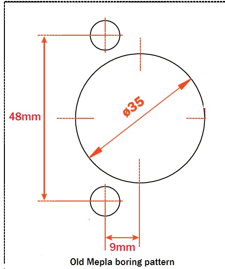

This is the old Mepla boring pattern (48mm X 9mm). Most everyone today uses the 45mm X 9.5mm pattern.
View higher quality, full size image (460 X 550)
