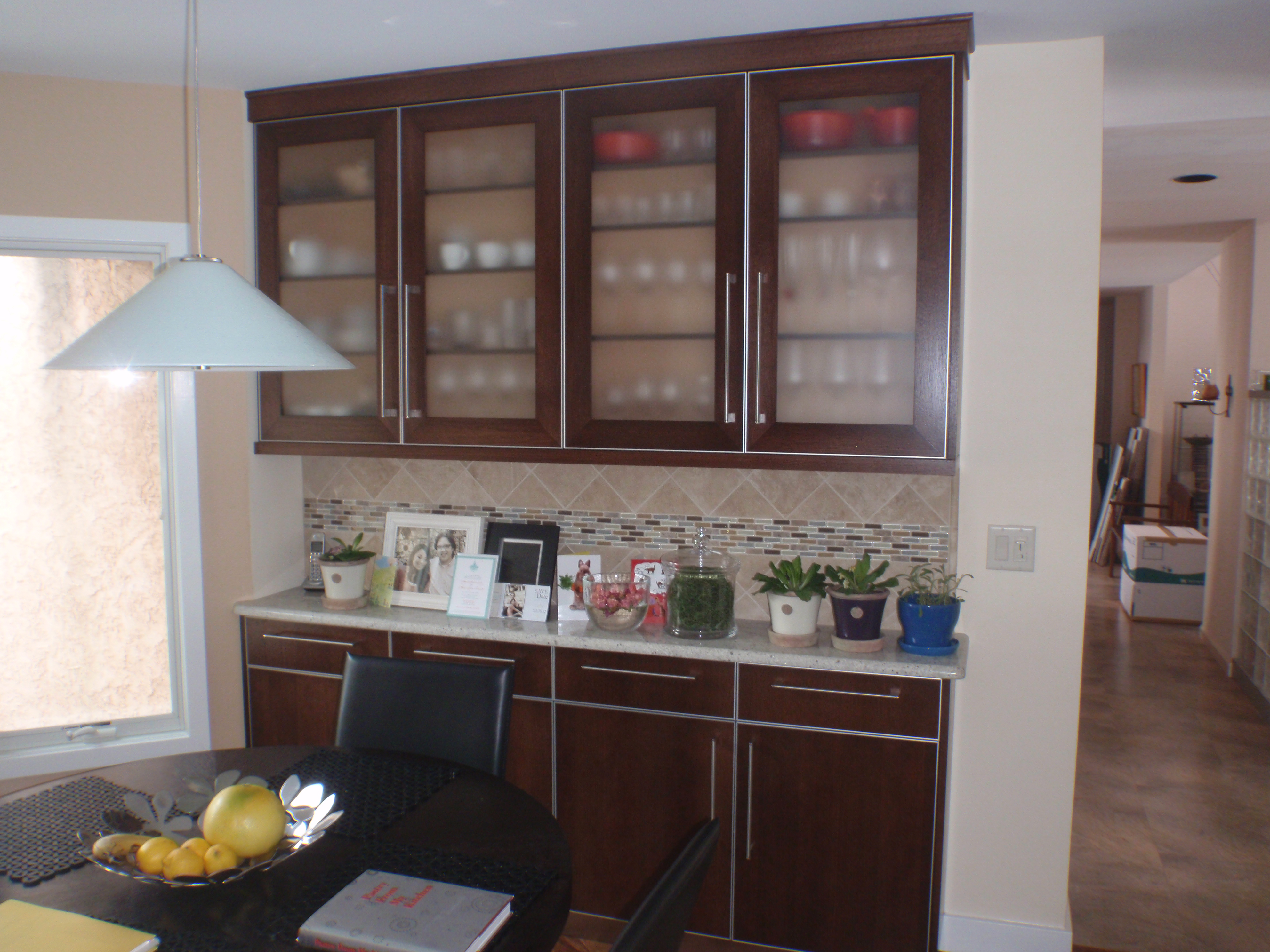

I've done a few modern kitchens with 1/8 x 3/4 anodized aluminum bar stock on the edges of laminate or wood veneer doors . Just scratch up the back of the aluminum with some 120 grit paper and glue and clamp , I use white melamine glue .Its surprising how strong the bond is .

Alan's looks pretty easy to install but I think Tom's look with just a 1/8" square edge is
what they are looking for. I researched all the sites mentioned and can't find Tom's look
in T molding. I'll try sample and glue as Tom suggested.
