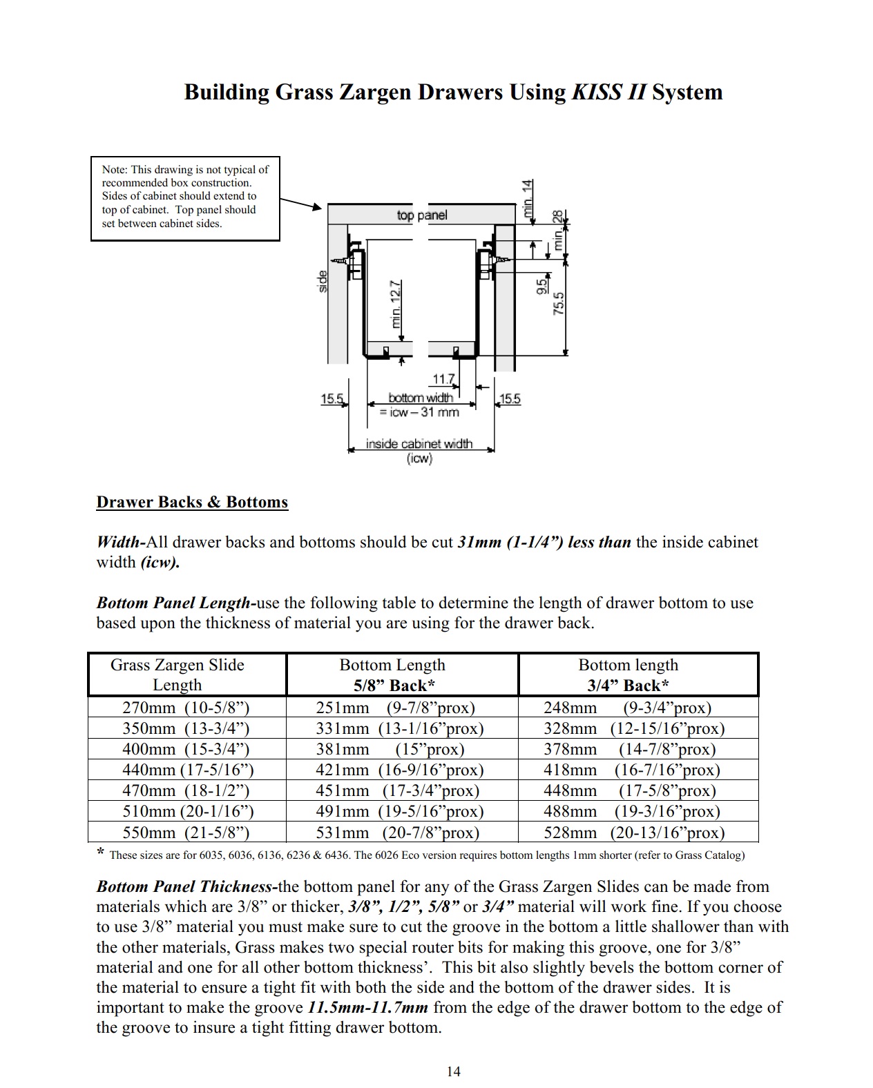

I just purchased a Grass Ecopress and Ram and wondering if anyone knows of any instructional videos on how to set up the ecopress and how to build these drawers. Also purchased these used from two different parties and the Ecopress was not used for drawers, what do I need for bits?

You are asking a question that is pretty much impossible to answer here in a few sentences. I would suggest you contact your Grass rep for a tutorial.
A good piece of literature to read would be the "Kiss System II" explanation of building according to the 32mm system. Here is one page from this study
Best of luck..
